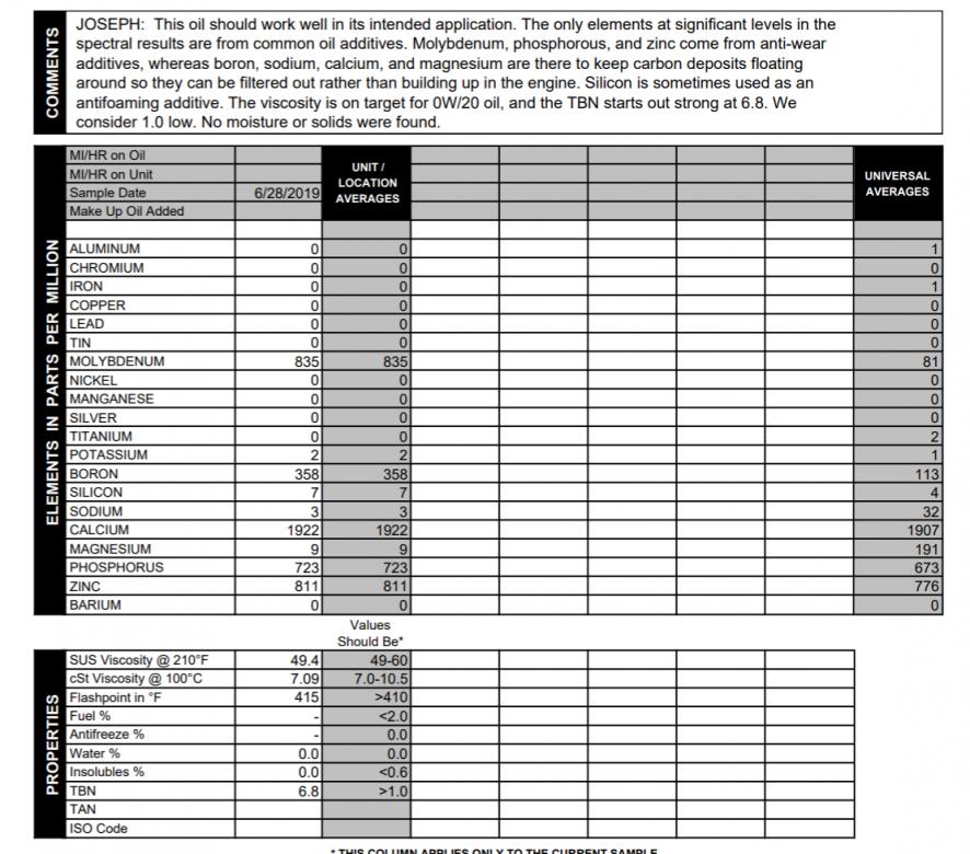

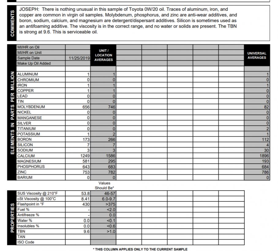

I am pretty active on BITOG and I posted the VOA on the new Toyota 0W-20 SN Plus blend - my sample was taken from a bottle with a blend date code of Oct 2019 - VOA below.
I also like Eneos Racing Street 0W-20 SN oil. This oil is not any cheaper but it's another option. It has higher moly and zinc than the Toyota oil. VOA below.

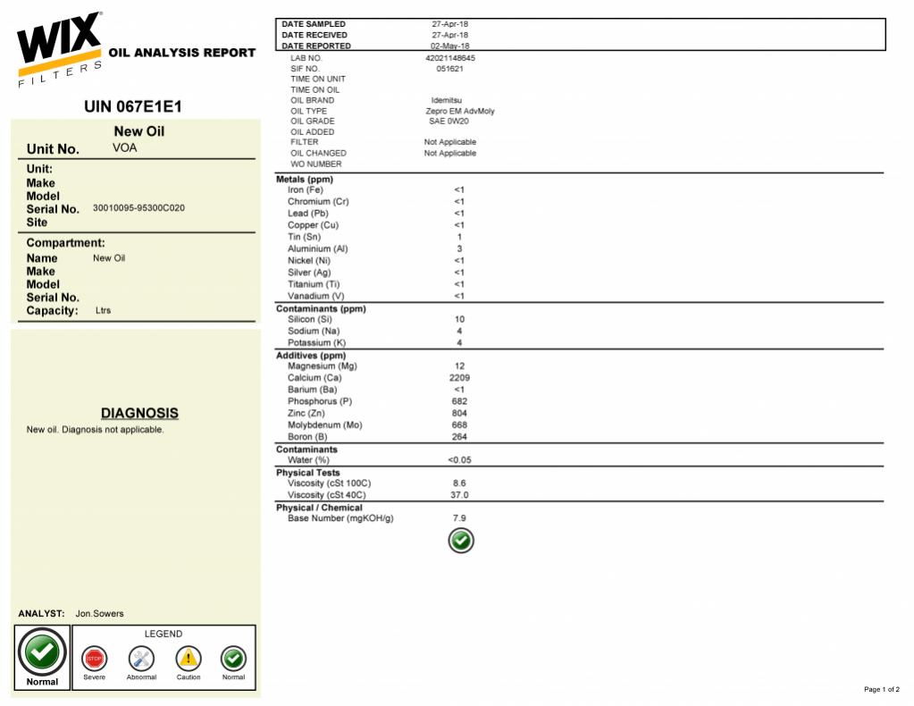

Idemitsu Eco Medalist Advanced Moly 0W-20 Engine Oil is also high in moly and zinc. VOA below. Amazon has a good price on this oil at $37.00 for 5 quarts - Amazon.com: ZEPRO 30010095-95300C020 Eco Medalist Advanced Moly 0W-20 Engine Oil (5 Quart), 160. Fluid_Ounces: Automotive
All three also have healthy doses of Boron:
Moly Content
Toyota - 656ppm
Eneos - 835ppm
Idemitsu - 668ppm
Zinc Content
Toyota - 753ppm
Eneos - 811ppm
Idemitsu - 804ppm
Boron Content
Toyota - 173ppm
Eneos - 358ppm
Idemitsu - 264ppm

Wow those 0w20’s are loaded with additives! Do you know anything about the base oil used in those?
Yes all have big additive packages. Plus a lot of calcium in the ENEOS and Idemitsu oils as well. All are Group 3+ base oils.
The anti-wear package in the ENEOS oil is the highest Moly & Zinc package I have seen in an API spec oil. When I use this oil I do get slightly better MPG's. It's an interesting oil.
ENEOS is manufactured and sold by JX Nippon Oil & Energy Corp., the largest oil company in Japan. They manufactures/blend for the US market in Schaumburg, IL
Idemitsu oil is the factory fill in Mazda's. Idemitsu manufactures/blend for the US market in Jeffersonville, Indiana. They are the eighth largest lubricant manufacturer globally.
As noted in the United States - Toyota's oil is a special blend done by ExxonMobil. It's a good stout oil - at ~$6.50 a quart it's very reasonably priced for the additive package.
