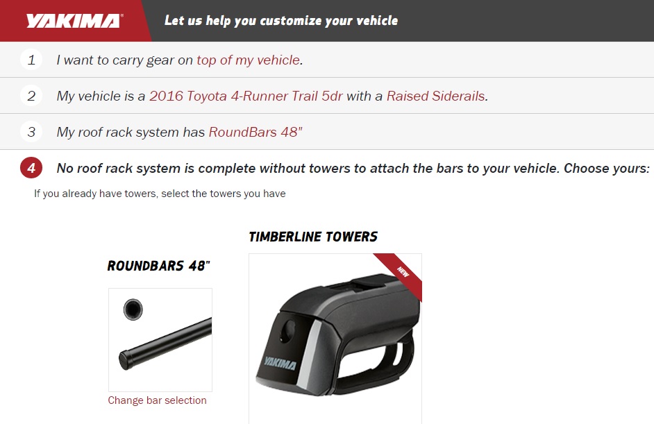

I have yakima railgrabs and 48" round bars that we bought for my wife's Escape that I used before on my factory rails before I got a Gobi. It looks like they've been replaced by the Timberlines. If you go with round bars, I would go longer that 48", try the navigation below.

I've done that the factory bars are flat ,and if I got those would it be level with the factory x bars no one knows?

The yakima system will sit on top of your rails, so it will be higher than you factory crossbars.
There are 4 yakima Bar choices, round and then 3 types of aerodynamic flat bars.
