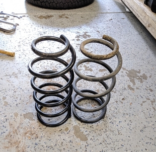

I haven't been able to find that same info on the 5th gen's, people all seem to have differing views on the springs. I'll measure/photograph the 4th vs 5th gen's when I get around to putting them in. Figure new 5th gen springs, even if they are the same, are worth the $60 i paid for em.

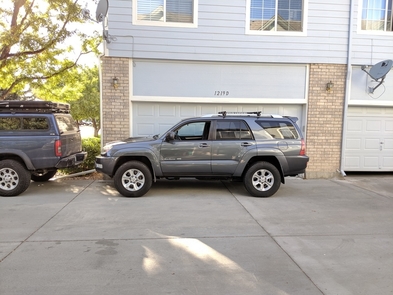

I personally just put some brand new (<5000 miles) REAR 5th gen springs on my 2004 4Runner V8. I gained about 1/2" of lift or so. They do have 1x more coil wraps than the 4th gen ones I had. Driving, they feel much stiffer, but that may be due to the old ones being worn out a bit (160,000 miles).
As far as fitment, they are a perfect fit with no modification needed.
In the attached image of the 4Runner, I have adjustable Bilstein 5100's on the front set at +1.75" using stock 2004 V8 springs. 5th gen coils and Bilstein 5100's on the rear (gave me maybe 1/2" lift there due to the nitrogen charge, 1/2" from the springs), and 265/70/17's (just for reference on what you're looking at).
