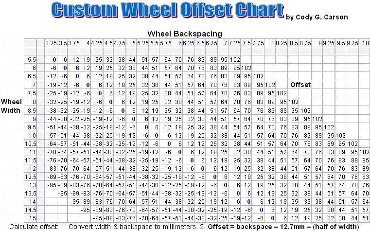

harper7 Senior Member May 29, 2012 #4 JeepWinch said: What is the offset for these wheels? Is it the same .75 as the 2011-2012 FJ wheels? Thanks! Click to expand... If you would have asked over in the 5th Gen section you would have gotten a quicker response. They are a 17x7.5" rim with 4.5" backspacing. That translates to a +6mm/.24" offset. Attachments MaxWheelOffsetChartbyCodyGCarson.jpg 117.8 KB · Views: 6,844
