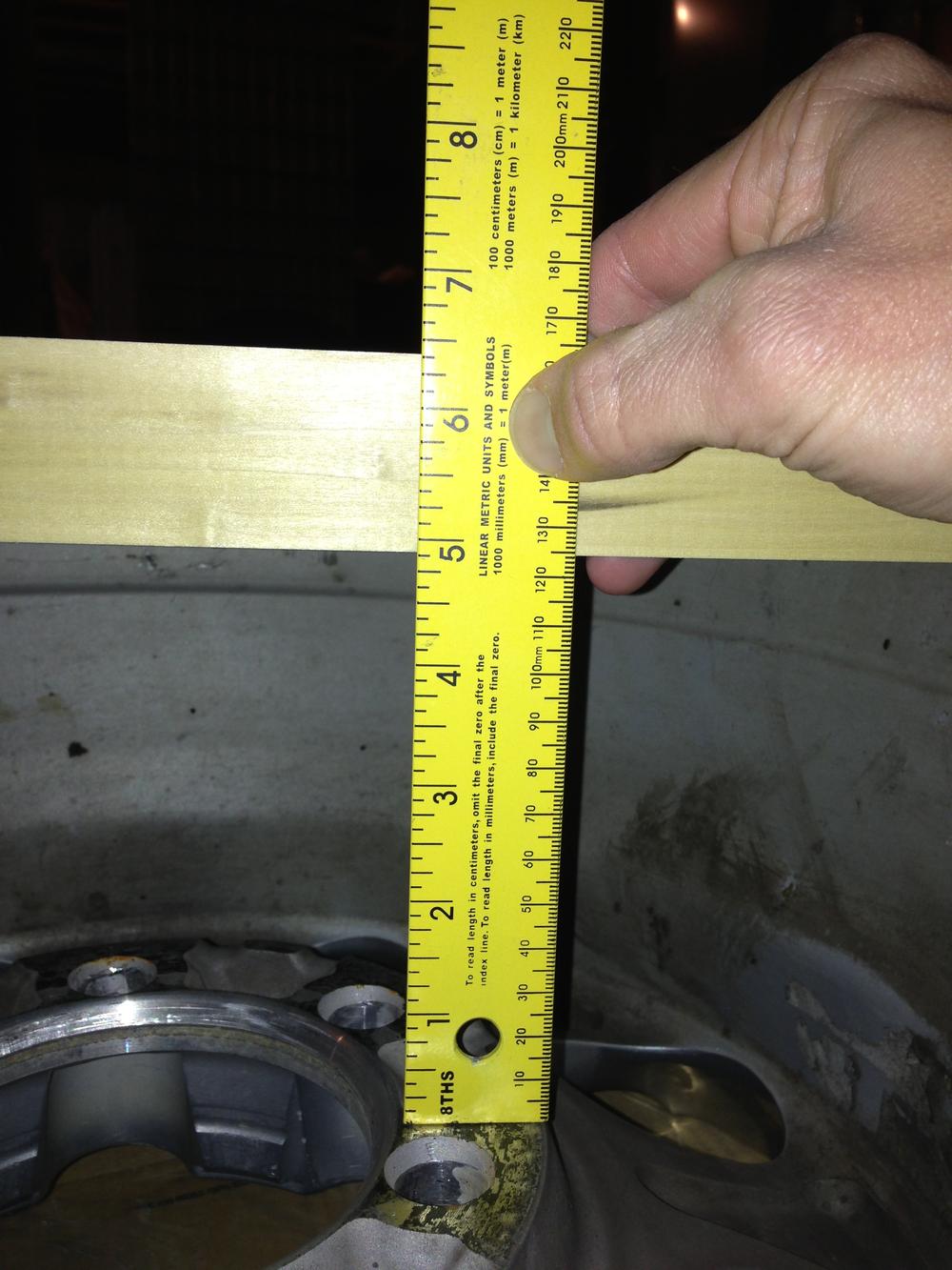

I never owned a TE wheel so never measured the backspace on one of them. As I mentioned several times before.....nobody has ever measured and then reported the backspace of a stock TE wheel in the last 4 years they have been out. Nobody!Come on people......it's not that hard, however it is a little more challenging with the tire on because you need a straight edge of 16"-17" because it has to be flat on the backside of the wheel and not include the tire bulge.I'm betting that it's 4.5" or maybe 4.75" since it's a 7.5 width.
Challenge accepted.
And now, after 4 long years of anticipation, I present the first TE rim backspace measurement on the forum!!! (enter theme song from "2001: A Space Oddessy" here...)
I'm measuring 4.875"

Challenge accepted.
I count 124.25mm :D
Thanks for that!
