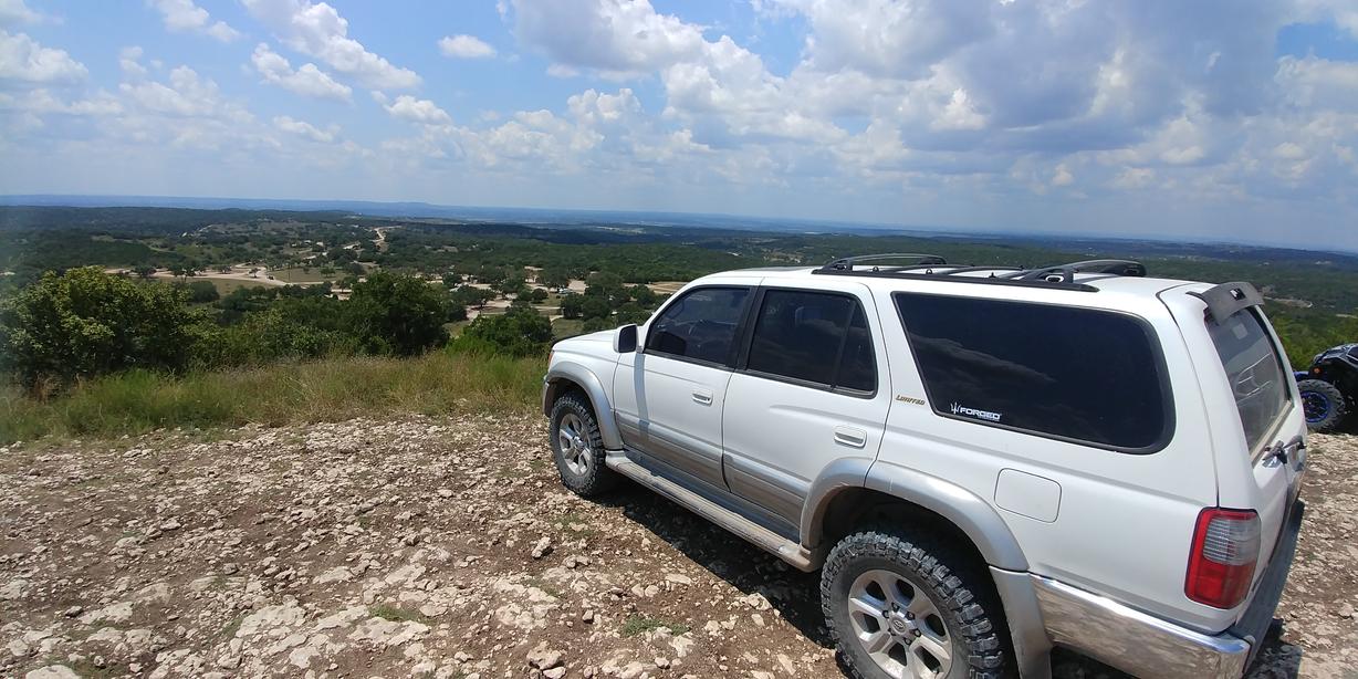

5gen wheels are fine, I'm running 15 SR5 wheels with no problems.

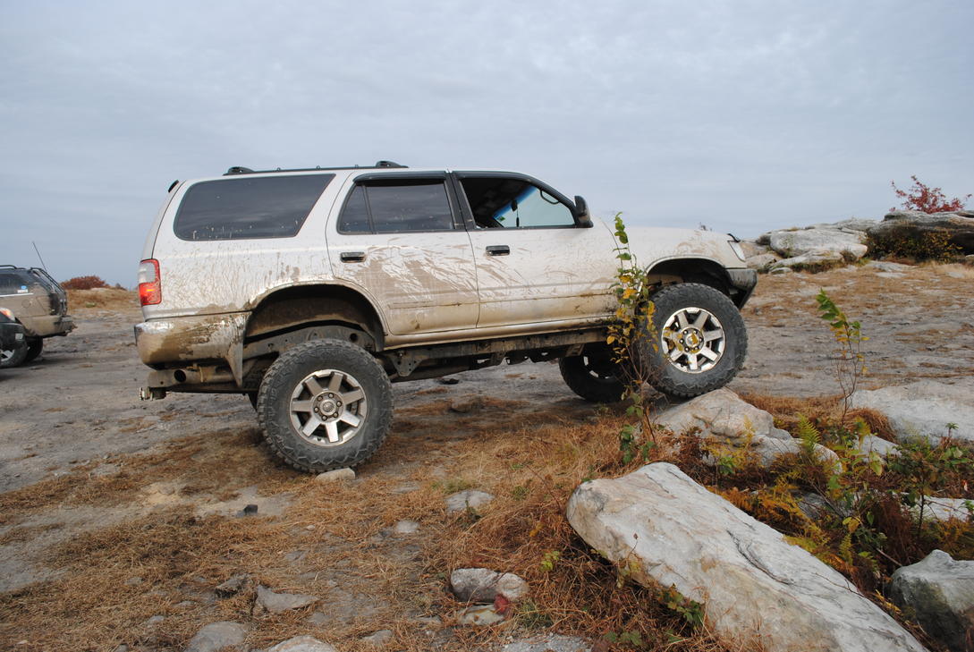

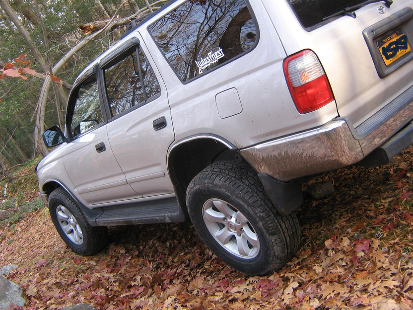

5th Gen wheels are the same offset as 3rd gens. 4th gens work as long as your tires aren't too wide. Here are some that I've run.
4th gen Sport wheels with stock 99 talls - 265/70R17
5th gen Trail wheels with TRD/8 wraps - 285/70R17
I run 1.5" spacers too but they weren't needed for the 4th gens. The tire was very close to the stock UCA though.
I never tried my 5th gens without spacers but with the All-Pro UCA's I'm sure they'd be fine.
