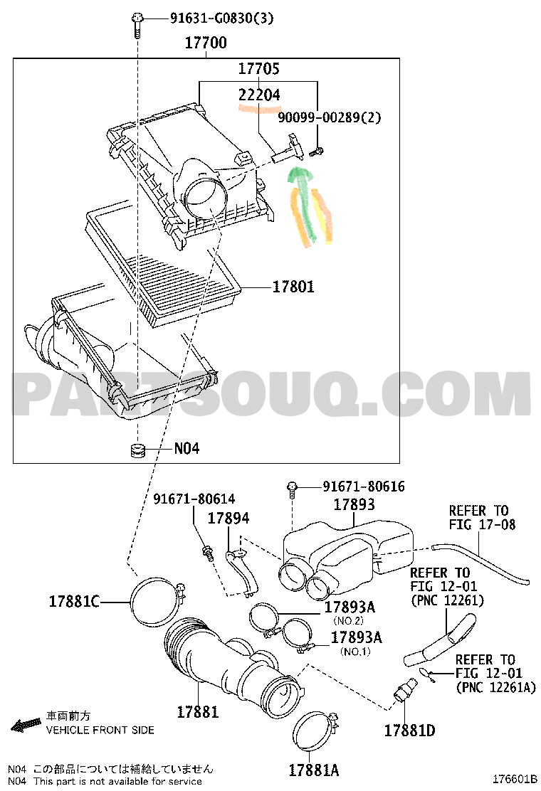

I would pull and clean the Mass Air flow Sensor - known as MAF sensor. Did not see it in pages 1-4 - maybe I missed it.
This device does not need to be deteriorate enough to throw a code before it causes MPG to suffer.
If not handled already - consider new air filter. Some may not agree as your vehicle has only 15000 miles, but age also comes into play. Your 4R is 6 yrs. old.
Update - I wanted to include a parts sketch of where the MAF sensor is located on the 5th Gen 4R - #22204 in pic - air filter housing - upper part of pic
