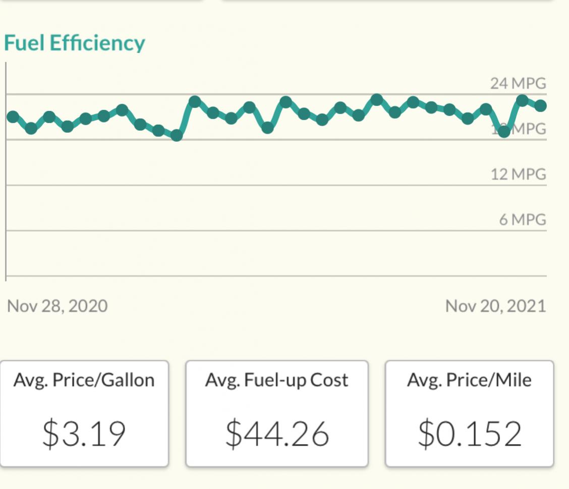

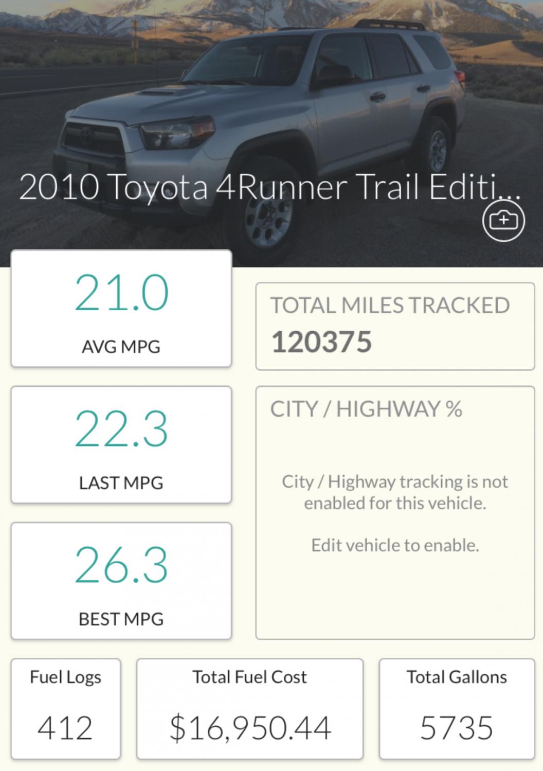

Still happy with my MPGs overall. It’s not consistent tank to tank but it has been year to year.
