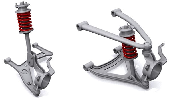

but in the front they are struts....
You are correct, and in hind sight the OP likely knows this and was indeed referring to the fronts as struts in his mind and asking if he needed matching rear shocks! :doh:
ahhh no, the fronts are coilover shocks not struts. Lets not confuse the new people.
A strut also acts as the spindle and is a steering pivot point. Were a 4Runner has a separate spindle that is not attached to the coilover.
Good info on Shock vs Strut vs Coilover Shock
Agreed, but they are listed as struts at a parts counter or online part sales.
For those that have no clue what we're talking about. Strut vs coilover
