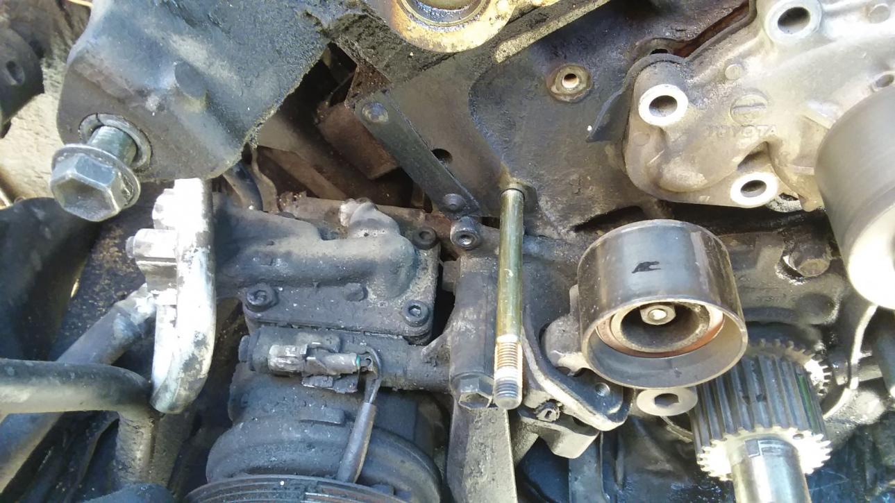

Not sure if peeps don't know that pass and driver side on the engine is viewed like ur sitting in the vehicle, only being this up as i have never seen the riveted vin on the driver side (only the passenger), unless it's diff based on something i am unaware of and its just been by chance all i have seen or on the pass if they have 1...
here's a pic of a 98 i'm working on

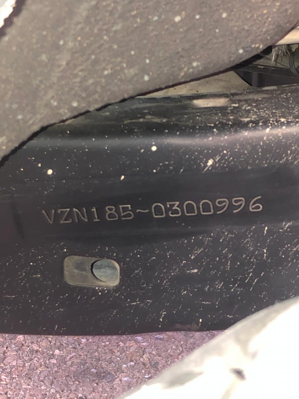

Not that it helps in this case but I learned that the frame stamp in the front wheel well shows the engine size it came with - VZN185 for 3.4 and RZN185 for 2.7 That's pretty obvious when you think about it. The last 6 digits are the vehicle's assembly line sequence number (and the last 6 of the VIN of course). Kind of a cool font.
