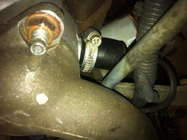

This is what the öil cooler on my car looks like...
Here you can see the outlet from w/pump to oil cooler blocked

I am familiar with what you are talking about. The 5VZ is a great engine and easy to maintain. You've changed almost everything I would've suggested. The fan clutch is something to look into. As far as the oil cooler. My JDM motor didn't have the setup. So I ran 2 oil filters. I know about the water pump outlet for the cooler. I'm not having any heat issues at all. Check the system for air by parking on an incline and filling coolant while running the heater. Also the fan shroud may be missing and that will cause over heating. You could have a clogged A/C condenser, not letting air reach the radiator. Lastly you have a water leak somewhere and it's lowered the boiling point of you radiator causing the toyota to over heat quicker. Hope it helps
