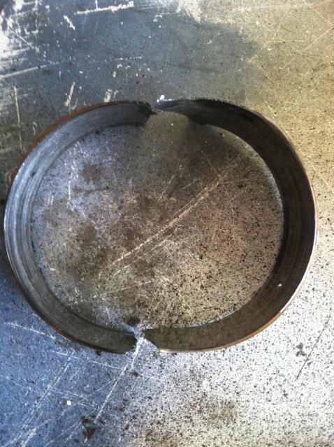

I finally found some time to pull the motor and tear it apart. Turns out my guess was wrong and the noise was in fact coming from the bottom end of the engine. The #2 rod bearing was spun.
Here's the #1 rod bearing which is a somewhat healthy bearing for having 256k miles on it:
And here's the #2 bearing that was spun and is obviously destroyed:
Out of the 256,000 miles on this engine, 100,000 miles were with a supercharger and the engine was dyno tuned to 250hp and 300 ft/lbs torque. I have heard that these blocks can safely handle more than that so I don't know if this engine just had a life of 1/4 million miles or if the supercharger helped wear it down?
So, with the spun bearing there is obviously damage to the crank. With the cost of machine work on the crank I might as well get a new crank. Now that I know I am looking at new left and right heads, new crank, full rebuild kit, machine work on the engine block, fluids and misc parts and pieces... I need to weigh my options on either rebuilding what I have or buying an assembled long block.
