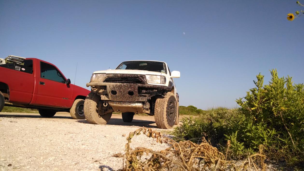

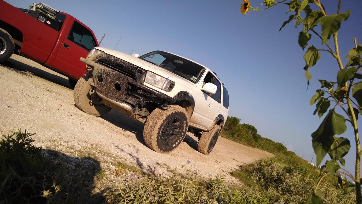

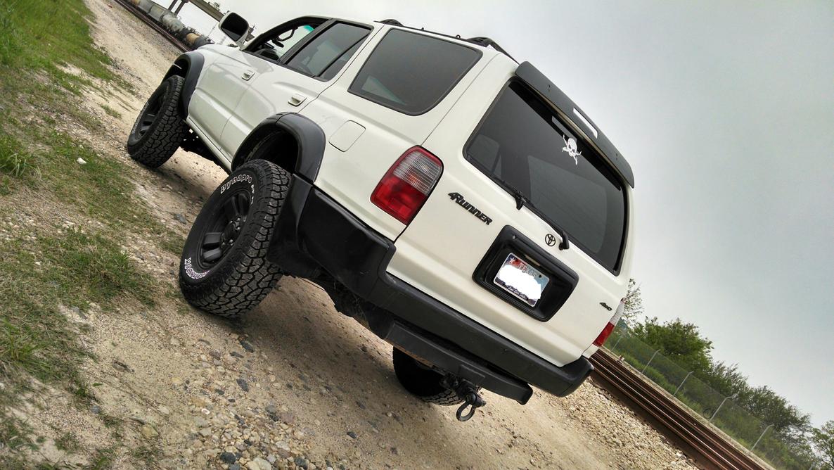

First mod was to remove the ugly running boards and take her to the beach!
Next I painted the grille black, the Toyota emblem white and plasti dipped the wheels and badges and re-painted the hitch and spoiler.
I had some extra fog lights laying around from when I sold my Tundra, so I threw those on there. Much better!
Next it was time for those ugly scratched to heck silver fender flares to go along with the chrome rear bumper. So I picked up some painters tape, rubbing alcohol, Duplicolor adhesion promoter, Krylon glossy black, 220 grit sandpaper, a can of primer and a Jegs magazine that came with my B&M 70264 and went to town sanding and painting. Turned out great I think for the price!

That looks a lot like Surfside beach! What size piece did you use for the ISR and what made it so difficult?
Lol yep it was Brian beach. And its a piece for the diy intake kits from auto zone. It was difficult because it was a little to big. I had to heat up the rubber in boiling water just to slip it over.

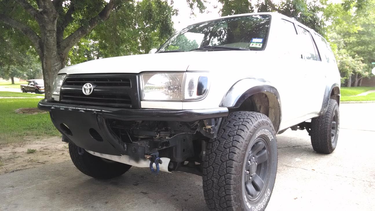

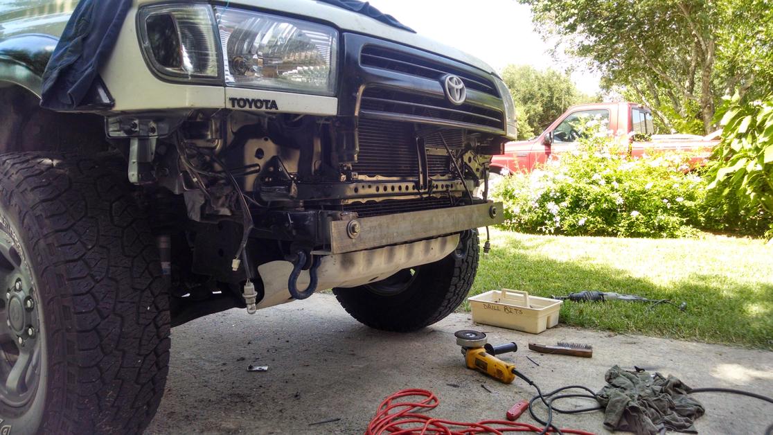

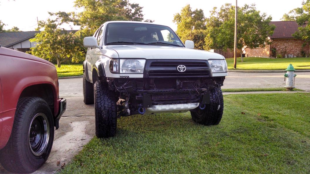

Well I'm a little late to post these, but... My lift and started my bumper build will put more pics up.

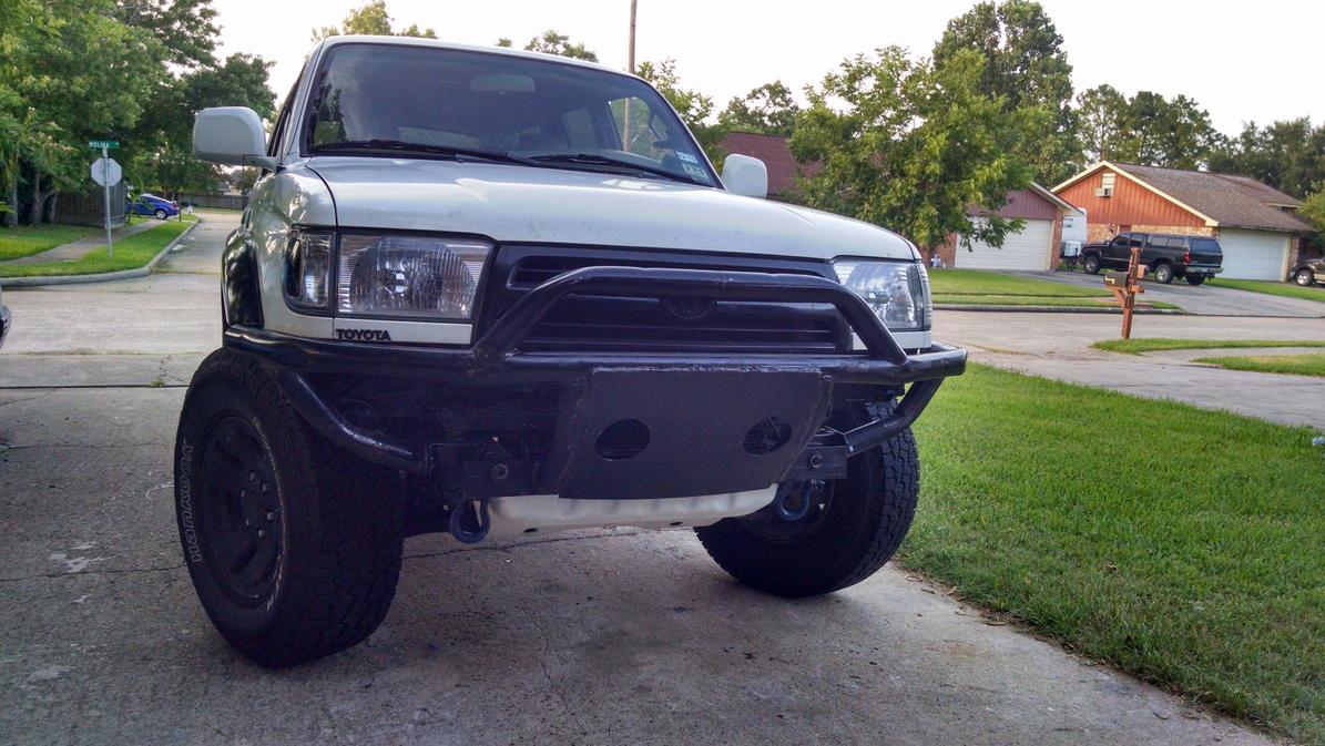

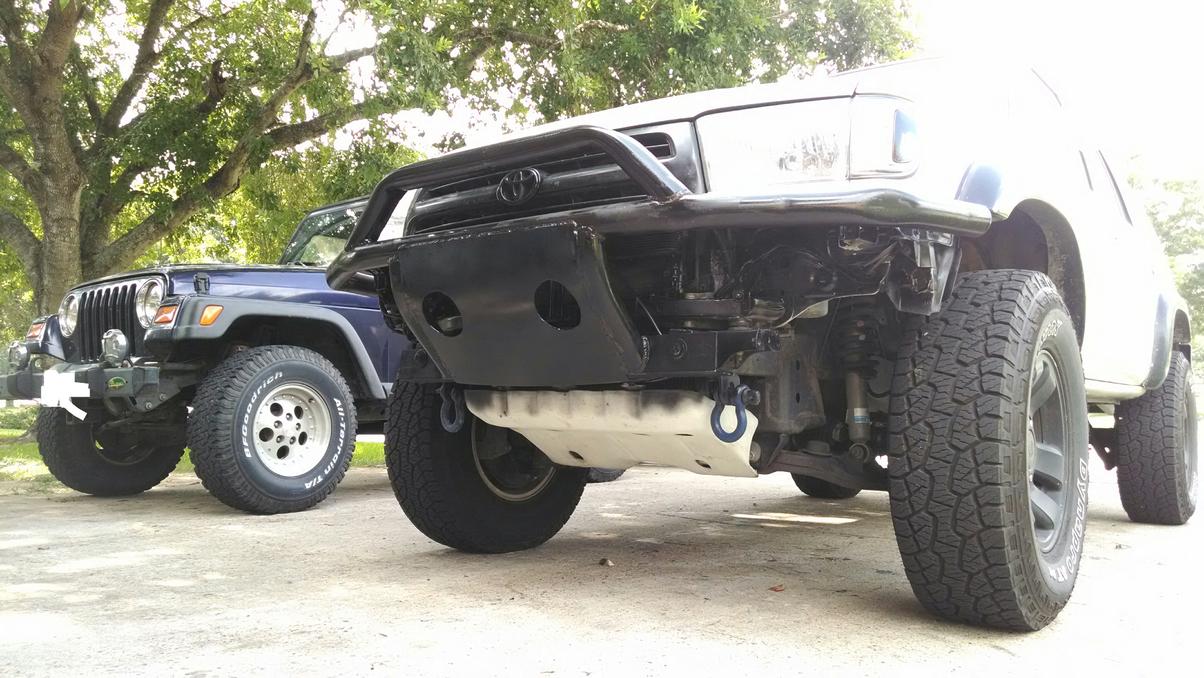

Got some free metal from work for the center piece/skid or whatever you would like to call it, free handed two holes with a torch and cleaned it up with a grinder and welded it on. Still have more trimming to do, weld on some side wings or whatever you want to call it, expanded metal (mesh) and a light hoop.

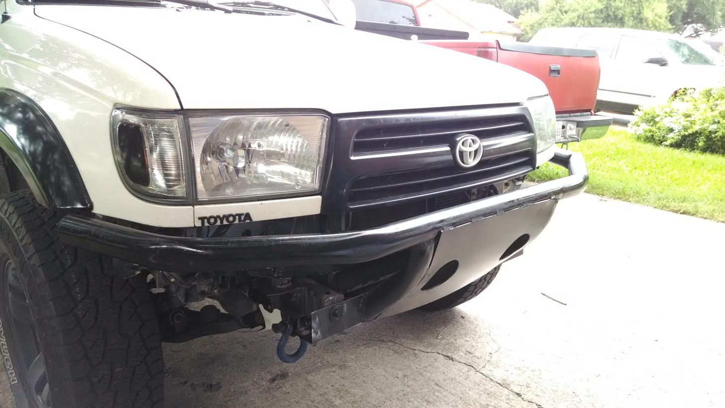

Got my light hoop on.

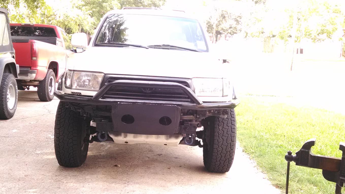

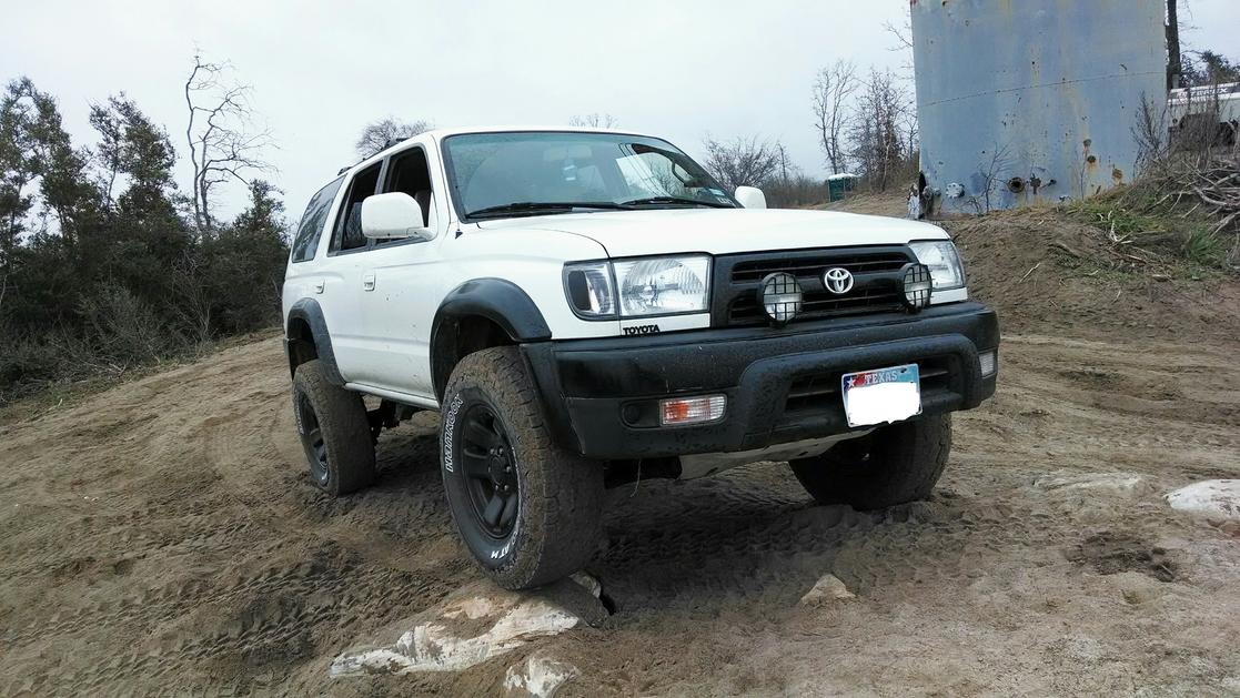

Went fishing and took a couple "poser" pics. Still a lot more work to do on the bumper, kind of "plan as I go" type thing. But I am liking it so far.
