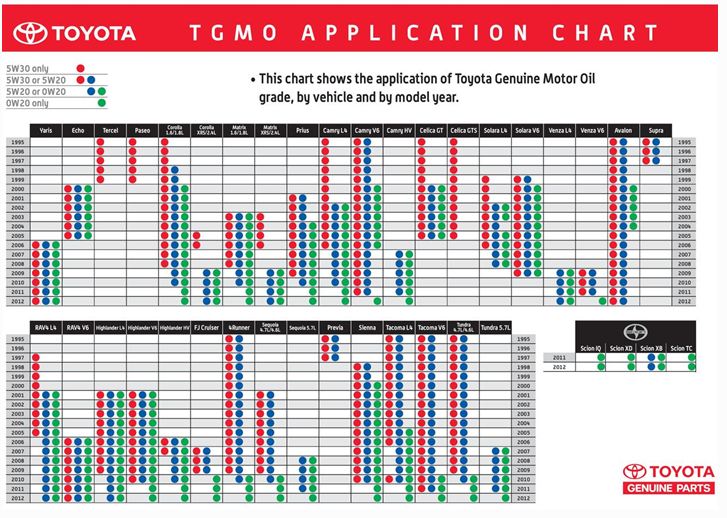

I feel better after looking at this...(hope the file uploads).

You're fine. In April '06, Toyota issued a TSB and the 1GR-FE is amongst that list of engines that can use 5w-20.
