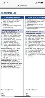

In Canada it’s every 5,000 miles including oil changes. This is off the US site.

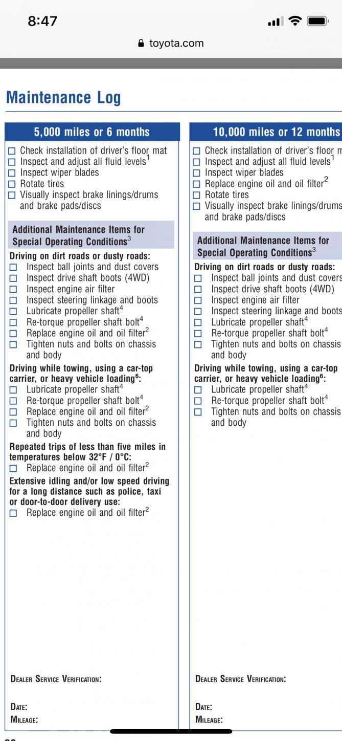

Keep in mind 6 month oil changes would be appropriate if you meet a special operating condition:
Repeated trips of less than five miles in temperatures below 32°F / 0°C:
Replace engine oil and oil filter 1
Extensive idling and/or low speed driving for a long distance such as police, taxi or door-to-door delivery use:
You should perform these additional maintenance services only if the majority of your driving is done under the special operating conditions indicated. If you only occasionally drive under these circumstances, it is not necessary to perform the additional services.
