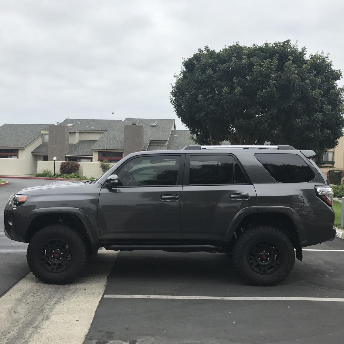

At my current setting im at 2.75 of lift up front, if you go to the lower settings you might not like how it sits. I feel your pain on the adjustments with 700lb springs on the 6112s. Coilovers would've been easier to adjust, but I wanted to try this set up first. I did a lot of research and it seems .0001% of us with 6112s are running 700lb springs. First time I put them on I did set them at the 7th perch and had 4.5 inches of lift. Looked nice but all my suspension angles were way off. Brought down to 4th setting and have stock rake which I always liked. Might go up to 5th setting depending on how much it actually drops with the incoming mods. First picture is of the ball joint at current height, second if of the setting at 7th perch, and last one is how it sits now.

Can't tell by the angle but the bottom photo looks just as good as the midde photo.
