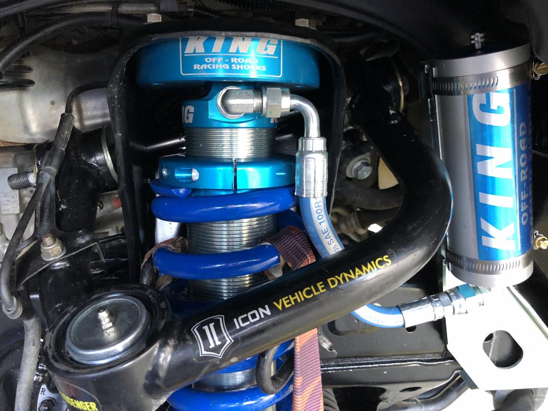

I just installed kings this weekend. I’m coming from Icons and had added a lot of weight to my rig. I had those maxed out with preload. I ordered the kings from Filthy Motorsports and went through the whole process with weights and pics. They recommended #600 springs, which sounded light to me, but I’m trusting an expert to figure that part out. At zero preload, the front was in the weeds (21.5” fender to hub) after a few emails, they recommend I take them up 4 turns. I did 8 and it brought the front up to 23.5”. With barely an inch of thread, I could go quite a bit farther, but I don’t need to. I may even come down a bit, depending on how it settles, because I thing they performed better.
What I don’t understand is why a lot of folks are at #650 - #700, Still needing preload. My bumper is on the light side, but I still have batteries, skids, winch, the whole Magilla.
I'm pretty sure it has a lot to do with the free length of the spring as well. They are probably using a 14" spring. Just my guess though, could be wrong.

I find this confusing as well. Hopefully someone can shed some light on it. I think you're correct about the 14" coil on the king setup.

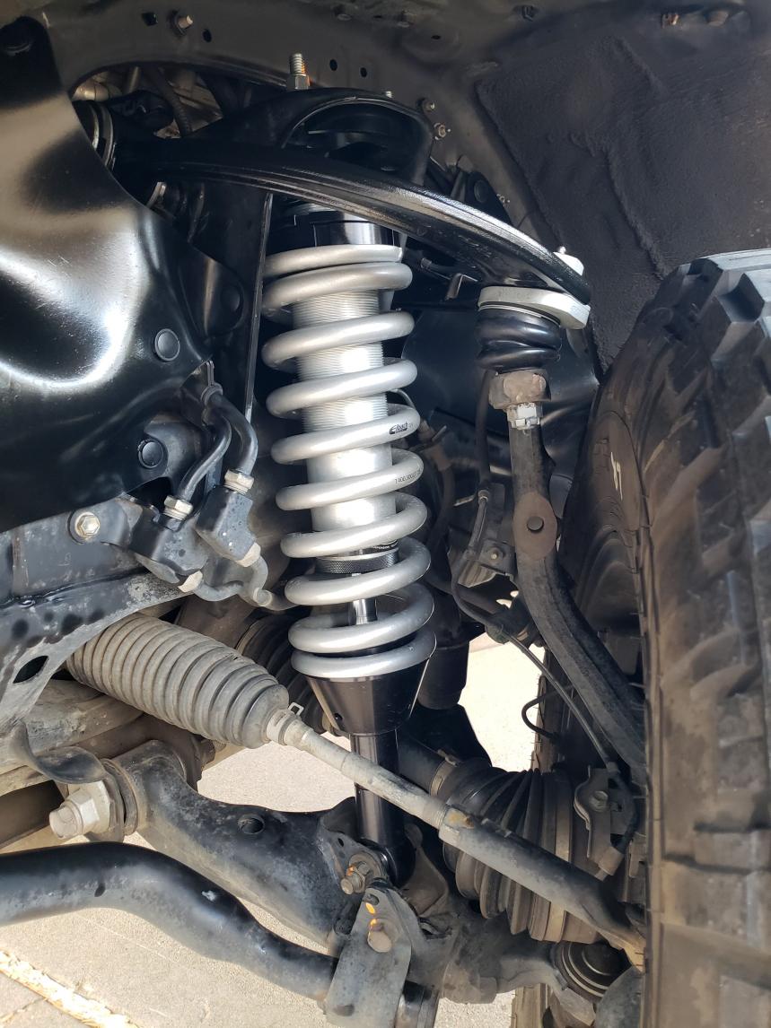

For reference my coils are 3" ID x 14" L x 700# with very little pre load
I attached a picture, you can just barely see the exposed threads above the collar at the top. Sorry about the quality. It's a blizzard today, I'll get a better pic later

I say go with the 700# coils. I have 650#x14 coils with hardly any additional weight, and to me it rides and handles perfect. Zero preload. So if you have a setup that allows for preload adjustment, keep that in mind as to how stiff it will feel.
