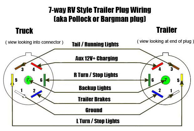

Didn't find this information anywhere... I would like if any of you ever tried to calculate the max amp output on the 12v power hookup on the 7pin connector?
I'm trying to figure how long it would take to charge my trailer bettery.
Thanks
I could not find anything in my 2013 owners manual. I'm sure there is a fuse or breaker to protect that line, but it won't limit the power until the max is exceeded. I don't think you can determine a charge time due to the capacity and state of charge of the trailer battery. It will supply full alternator voltage as it does for the T4 battery.
I found this diagram on line:
Yeah full alternator amp, but given the awg of the pin cable I guess it shouldn't give more than max 10-12amp?
I'm trying to figure if the power will be enough to recharge my travel trailer battery after a night with the 12v fridge, some led and running the heater fan... I'll be driving 5-6h a day.
After a little research, I came to the conclusion that the 12v from the 7pin connection will not be sufficient for charging the trailer battery.
The 12v lead is only 10awg and was designed to trickle charge the trailer battery and won't do much to recharge a ~11v

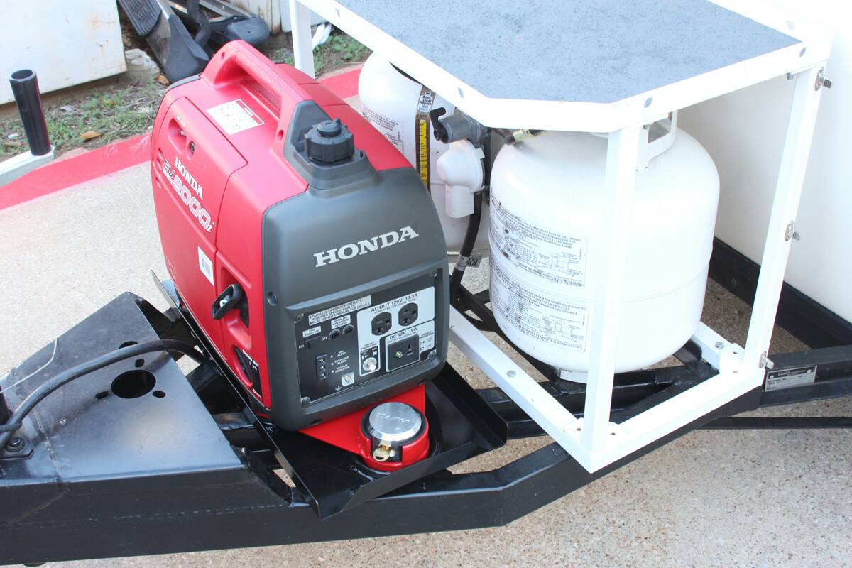

This left me with 2 option:
1) Fishing 2x 2awg from the truck battery to the rear of the truck and finish it with a Anderson plug.
Now I will have full alternator amp. Upside is (one day) I can also use it to power a rear winch [emoji6]
2) This is the most common (boring) option chosen by most camper: buying a small genset to recharge the trailer battery.
Upside is no need for elaborated install. Just plug and charge.
#10 wire will carry up to 30 amps, surprised it would be too small.
If you run a separate wire, I think I would use a battery isolator like is used when there are 2 batteries under the hood. Then the trailer can not discharge the T4 battery and it may give some protection if there is a problem in the trailer wiring.

Sorry to deviate the thread a little, but where did you get that awesome looking genny tray? I have a westinghouse portable genny I'd like to keep with my trailer in the same way you have yours rigged up, but was concerned about security.
