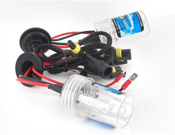

there is a black and red wire with spades
do i just plug these in to the factory harness??
i have the balast and ignitor the whole works just cant find my instruts

The bulb has its own plug in to the ballast then it has two wires one red the other black with spade ends which I believe plug into the factory harness

The two spades run thru the rubber cap next to the blub wires
The ballast has all its plug ins
These two wires come out of the ballast if I wasn't on my cell I would post a pick

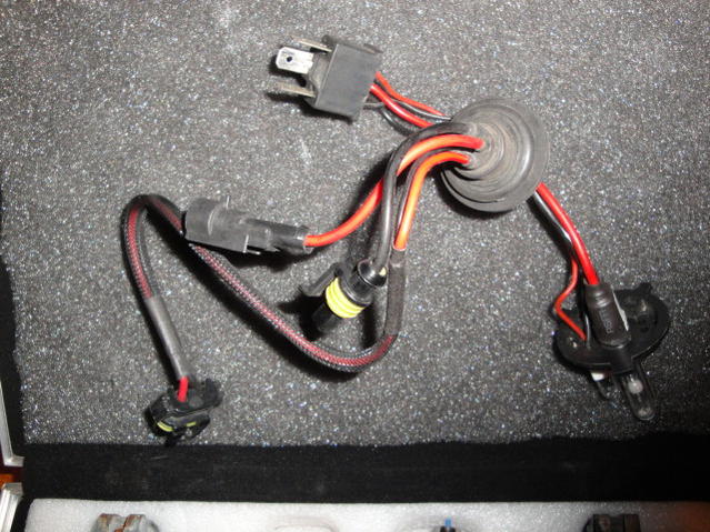

here ya go

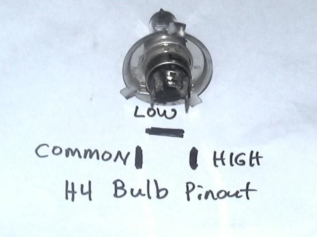

Most HID kits in h4 are hi/lo since the bulb itself has a dual purpose of highs and lows in the same bulb.
The two existing wires on your HID kit are for ground and low beam only. That is why there is no plug (since the factory plug has 3 inlets. One for high, one for low and one for common)
You need to plug the red wire into the low beam and the black into the common.
The low beam on an H4 is the only plug line that runs horizontally.
As for the high and ground, I'm not sure on our trucks which is which without looking into it further.
Here's a pic that may help.
h4blub.jpg~original

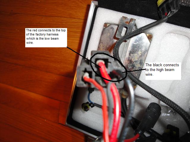

Now I know what you're looking at. I got some pics for you to see if that's what you're talking about. I'm pretty sure your black and red spades connects to the factory harness.
Here's my old HID set:
The picture below shows you where the black and red wire is suppose to connect to. Also use Moves2Music's picture that will help too.

Yep, I guess those go to the factory headlight connector. You'll have to play around and figure out what goes where, but a good piece of advice is that the plug that goes into the ballast will fit both ways, but have the little clip that is supposed to hold them in the correct way. Both of mine are backwards, meaning I needed to turn the connector around in order to get mine to function. I can picture it in my head, but it probably makes no sense trying to read what the hell I'm talking about.
Yeah I had to switch my connector around with the old set above. But I got a new set (bi-xenon) which didn't require the turning of the connector. :D
