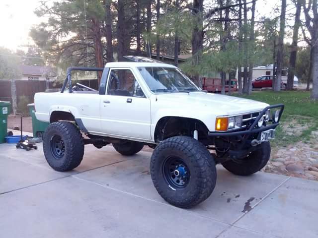

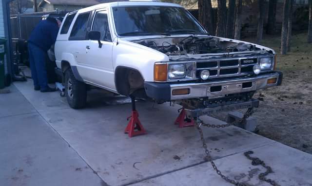

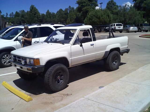

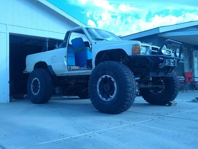

This is my project 86 4runner 1 tons 5.38 gears 5.3ls 4l60e 241 tcase 40" treps. Bring on the haters :)

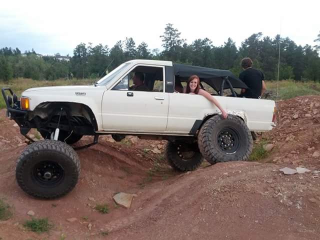

I really really hate that you have such a great truck is that okay?
Hopefully that chick got her thumb unstuck from between the tire and fender, she seems to be taking it pretty well.

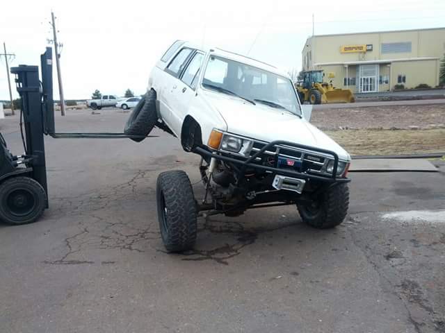

I do love the forklift picture, reminds me of trying to juggle raw squid.

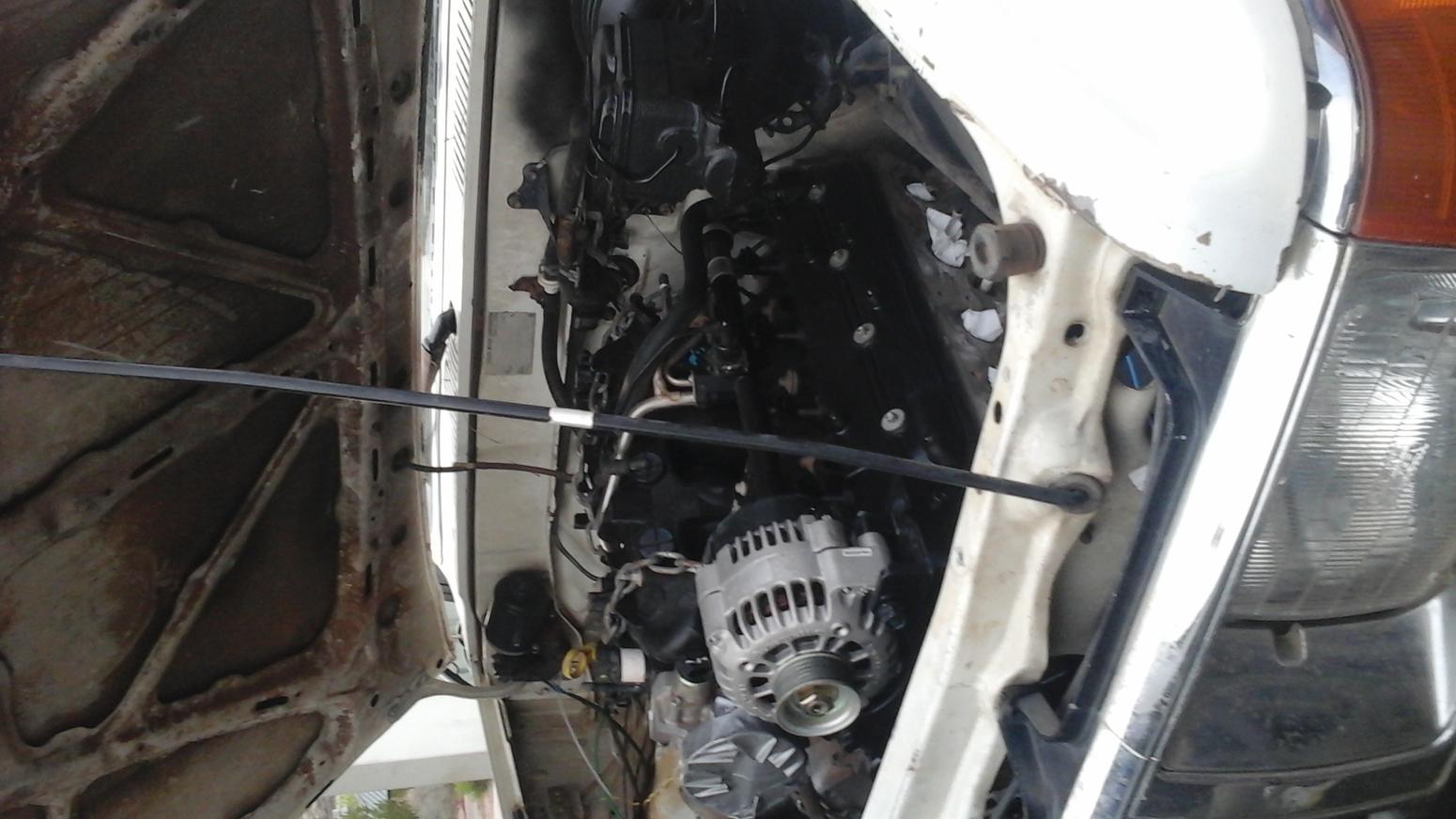

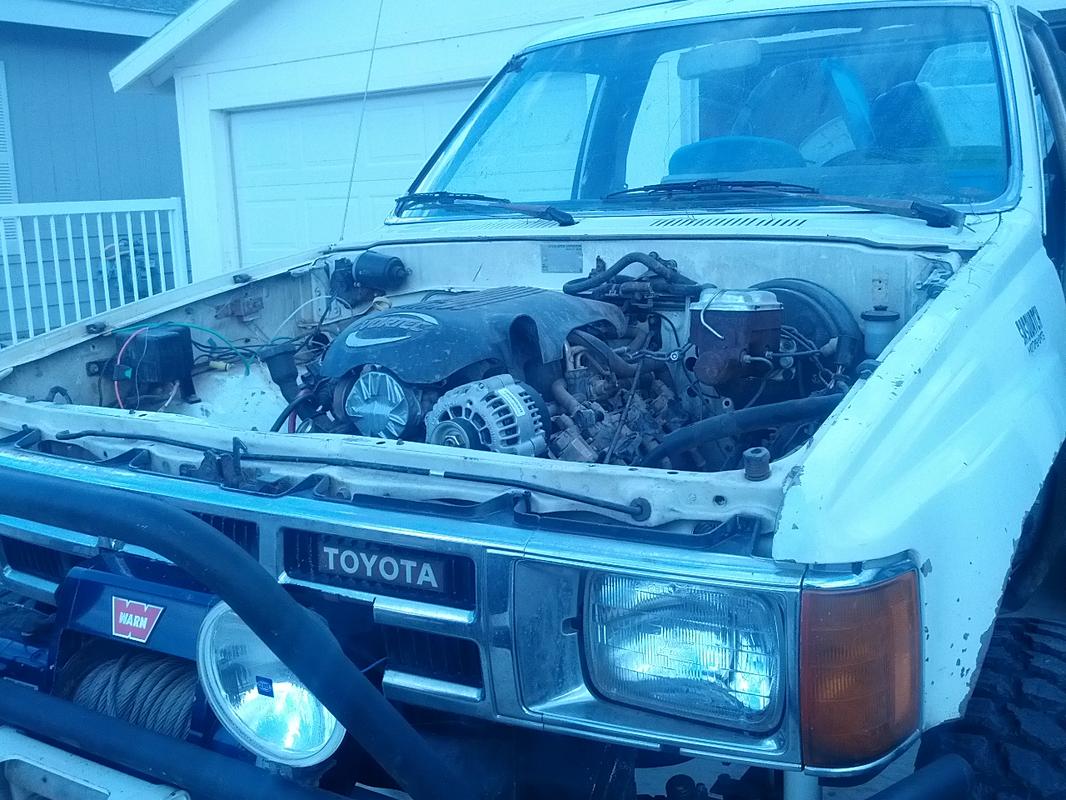

Awesome, love the 5.3 swap. Would be interested to hear more, which oil pan, radiator clearance, motor mounts, ect. Looks like you got the engine to sit really low, those LM7 intakes are tall!
I personally would have done a 5.8 ford eng but that's just me. That thing is bad ass brother. I dig it. And remember. Haters are gonna hate.....

Thanks guys usually gets a lot of hate cause of the gm drive train but living in a small town in AZ toy engines and parts are like gold. Here's a full run down of parts used.
2002 5.3 ls
4l60e with a full manual valve body
Np241 pass drop clocked flat with sye
S10 ls swap headers
Howell efi harness
F body Camaro oil pan
Rci fuel cell
Speedway motors fuel pump and regulator
-6 stainless braided fuel line with an fittings
Advanced adapters universal ls engine mount kit
Advanced adapters v8 swap radiator in double pass ls configuration.
Stock gm power steering pump with custom lines to toy box with hydro assist
That's off the top off my head I'm out of town for work for 6 weeks. There is about1/4inch of clearance between the hood and the intake. Front axle is pushed forward 3 inches that helps the difference clear the pan

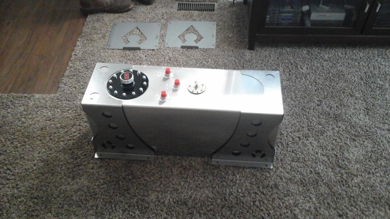

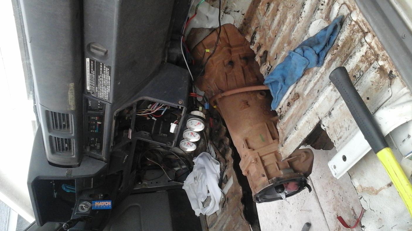

Working on the flat belly pulled the case and started hacking up the floor today. Got the new cell and mounts from artec industries too.
