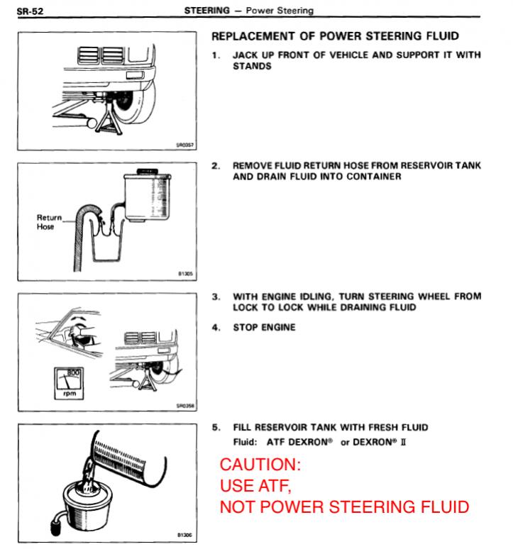

Power steering fluid - ????
CAUTION: ATF, NOT POWER STEERING FLUID, IS USED IN POWER STEERING
This applies even to our 2007 Corolla.

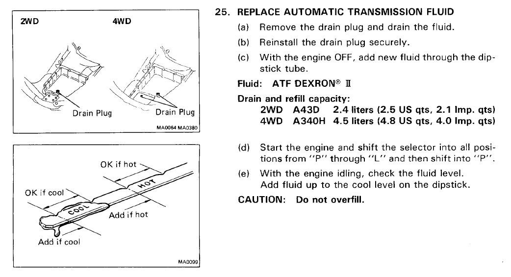

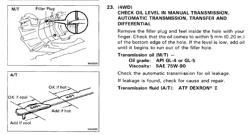

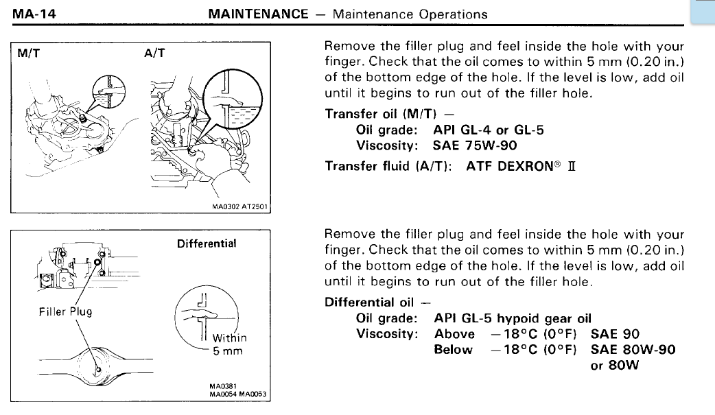

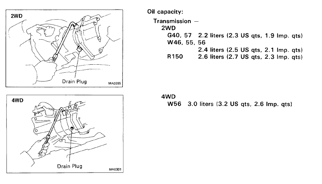

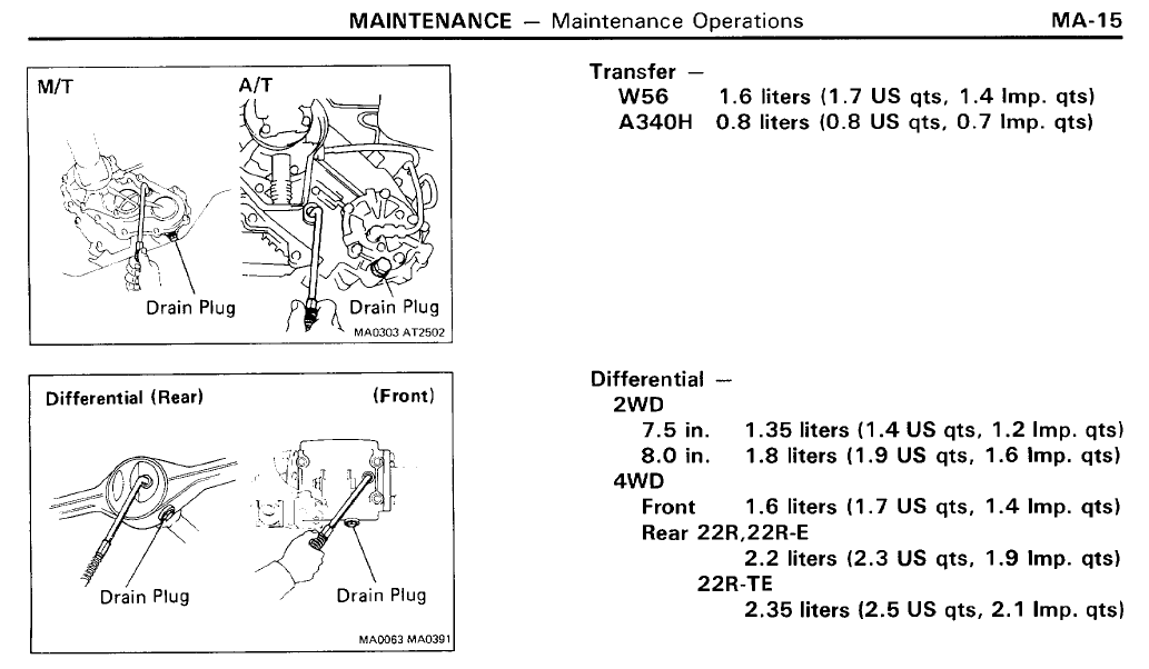

From 1988 4Runner FSM...
