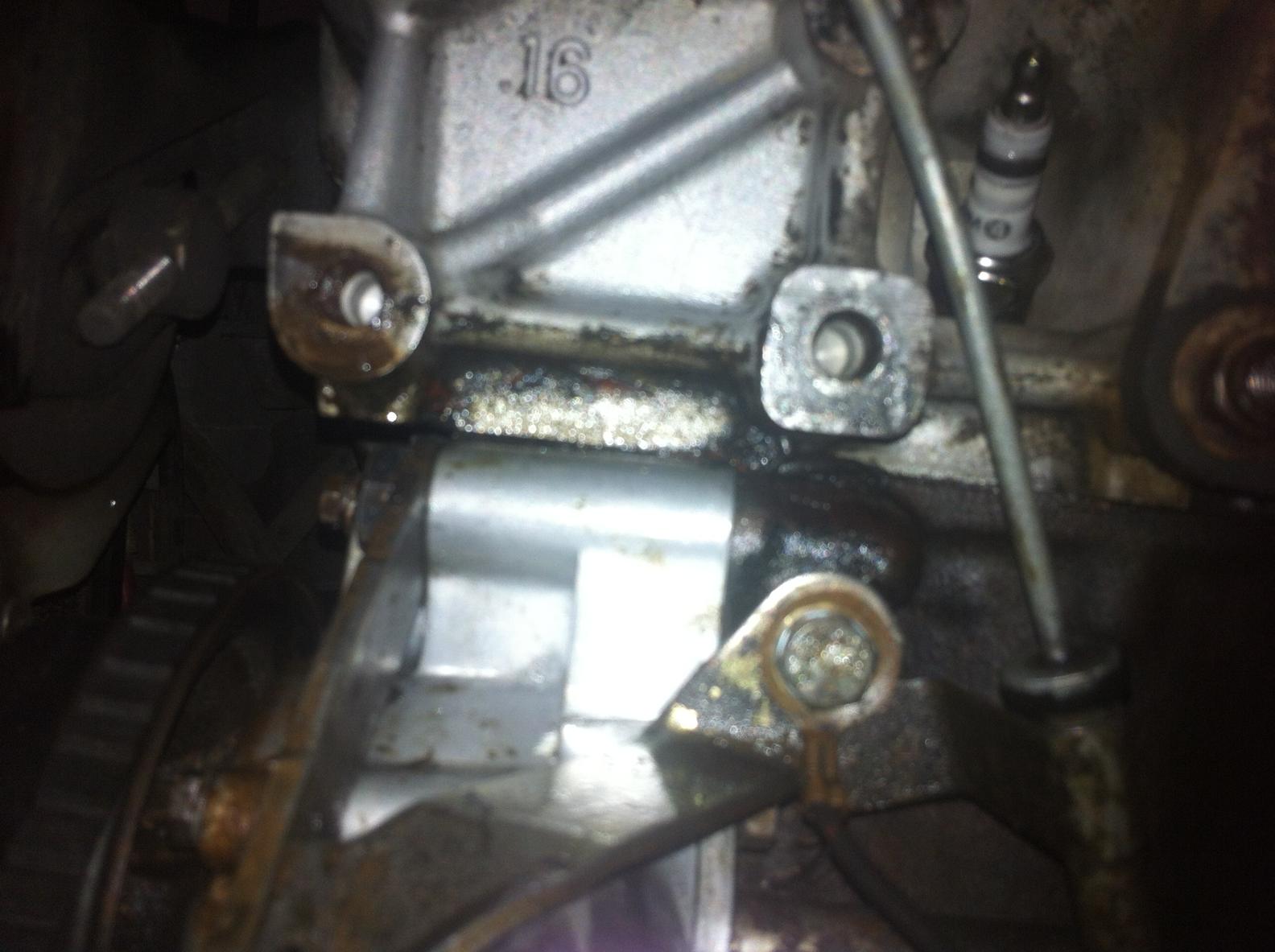

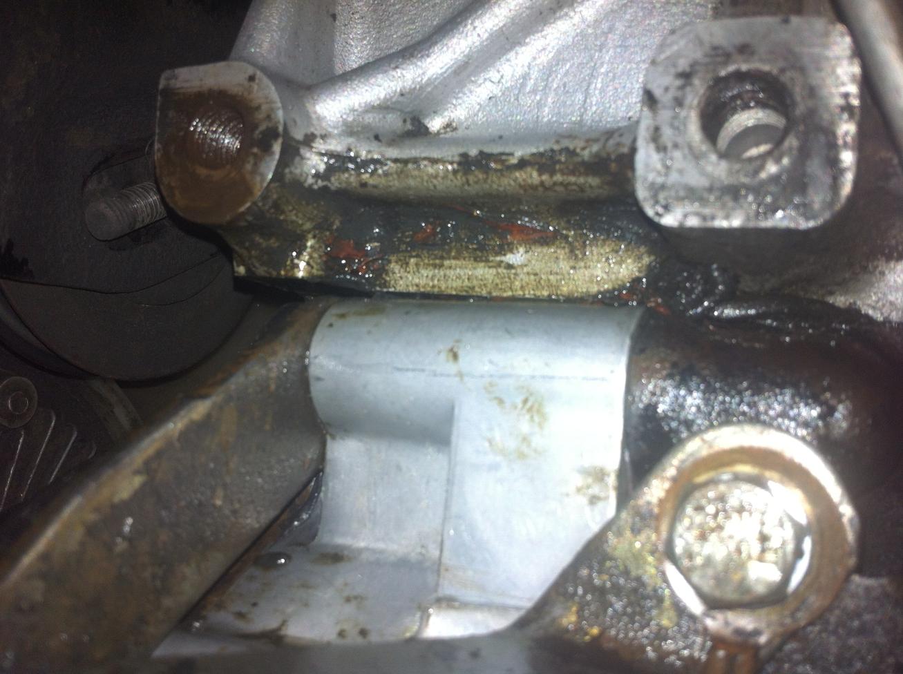

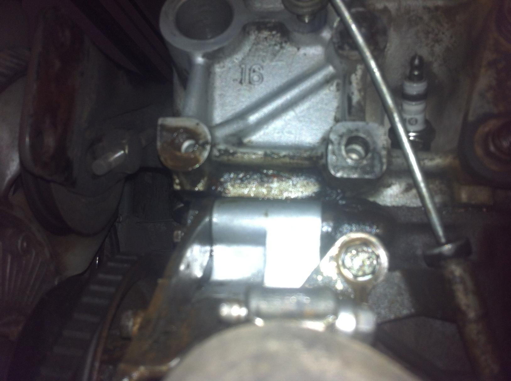

Oil leak. Owner i bought it from told me that he replaced some stuff, timing chain, oil pump, water pump (and i can tell by looking that its all new).
When re-assembling, he put the head back on, then the timing cover and says it "pinched the head gasket".
It is leaking oil and a couple of my grease monkey buddies dont think the leak is caused by the head gasket. I dont have any other of the common head gasket symptoms (milkshake oil, smoke in exhaust, it was running just fine no issues)
I started to clean it up and see about diagnosing this issue. (Fried the alternator with breakklean...yikes! i have a spare though) Couldnt figure anything out besides a general area of where its coming from. Near the distributor...
So i pulled the distributor and there was oil past the O-ring. I thought i just fixed it all for 2 bucks. Nope still leaks.
Ill throw up a couple pictures (phone pics...gah) I took last night (after i took the power steering pump and distributor off, cause its all in the way of where the leak is coming from)
Shed some light on this subject for me please gents. Ive been looking and looking at the threads on here and yotatech.com and im just not to sure about tackling this project on my own and feel i would be better off sending off the the shop down the road.

Oil runs down the front of the motor, through a passage in the head and behind the timing cover. If the head isn't sealed to the timing cover, it can weep oil without being a "blown head gasket". It sounds like that's what your PO is talking when he says the timing cover pinched the gasket.
If that's right, the easiest fix will be to pull the timing cover and reseal it.

That is very common issue when replacing health gasket without removing oil pan. When reassembling don't over tighten the bolt from head to front of timing cover,if you screw up it will crack it and leak. Also replace your distributor o ring
