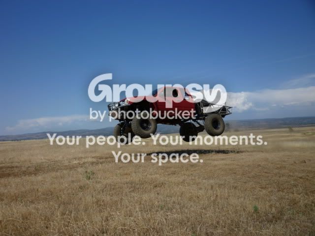

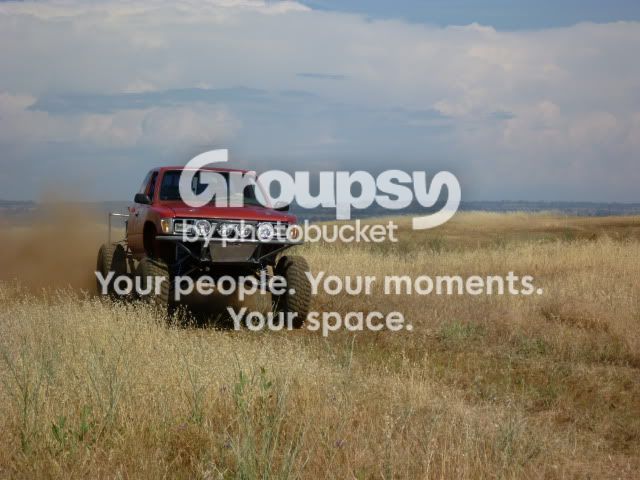

Read through this thread. Yes its a puckup, but it shares all the same front end components of your 4runner. This guy does good work.
The not so 4wd 91 toyota build - Pirate4x4.Com
P1000100.jpg~original
P1000093.jpg~original
