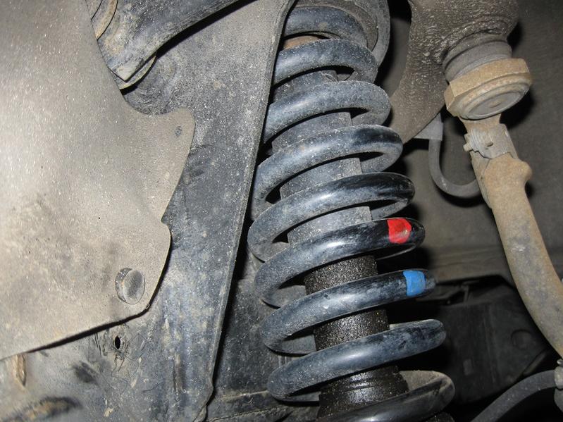

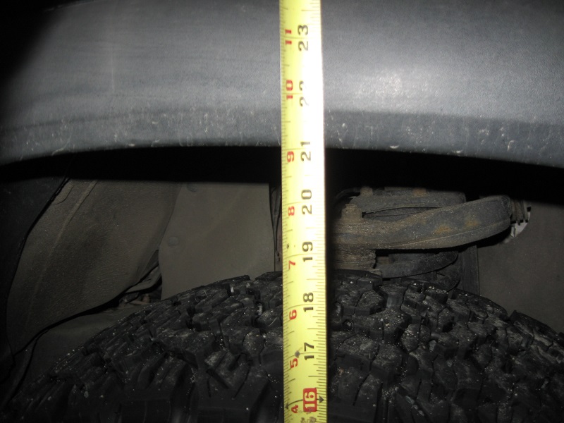

So in the process I have the rear figured out, but the front is totally messing with my head. I measure exactly and please please please help if you have actual measurements. I do not and will not add a front lift with more than 1.5" of lift. I have no interest in spending even more money on parts to make the lift work. This is a rig driven for hours at a time with not even a hint of tire wear after 30K and I want to keep it that way.
My rig has stock 96 springs and blown out shocks on the front. It wallows down the road like screwing a fat chick on a water bed. No matter what I do I need to replace the front suspension. So I measure, compare, study, and crap...my worn out 257K suspension sits higher than most. All numbers provided with measured rigs.
Measured from center of hub to bottom of fender lip is 21. My compiled info says a 99 Tall measures out at 21.5". 880 spring will put me at 21.75" average lift. A 881 spring will put me at 22.5 average lift. WTF...how do I get 99 Tall measurements with a worn ass suspension??
So I go with the 881 but will that blow out my caster and dick me on driving ability? Or do I go with 880's and do other things to make chain clearance. No I dont want to go with stock springs because I can buy aftermarket for a lot less. I'm already putting more than half of what I paid for the rig into it with suspension and a winch.
Tear me up, throw some ideas, I'm open to pretty much anything. WTH do I do for front springs and not have to do anything other than a standard alignment?

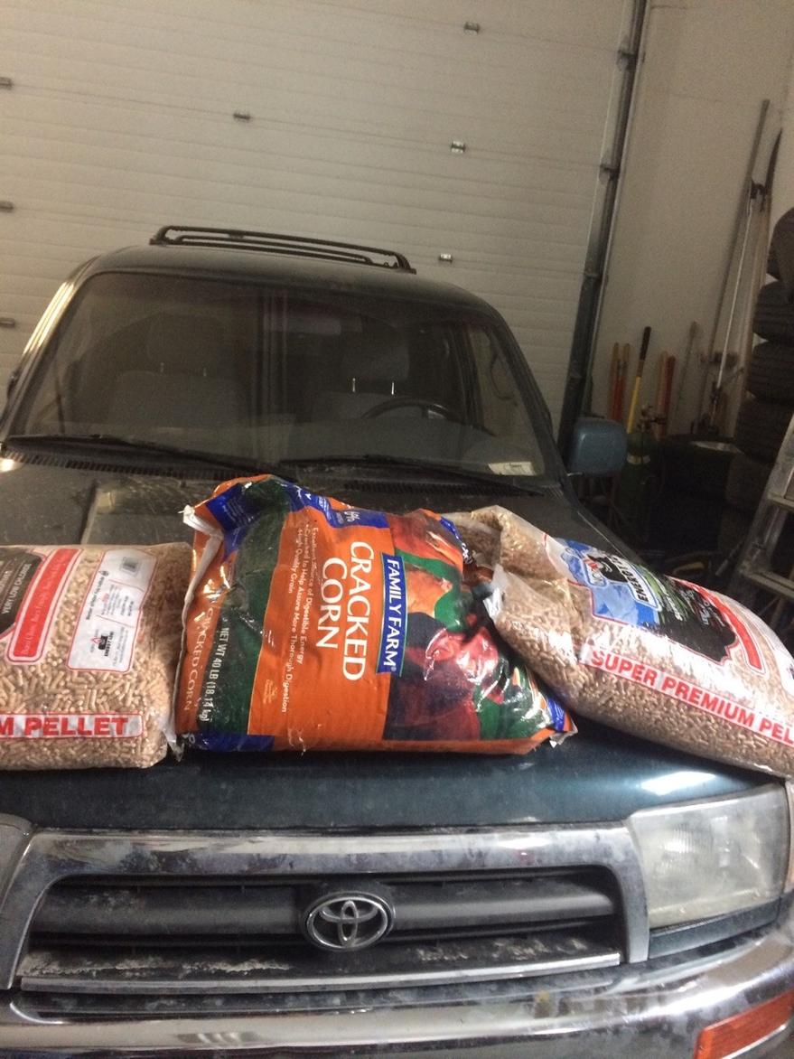

It has no winch on it now....but I did add 120lbs to the front and measure it. I lost 3/8" of an inch.
Nice. But this test would only work if you had the coils you want installed. I actually lost more than that. You need to drive a few days with teh weight. It just wore out my 881s.
I find my center of hub measurement to wheel arch varies based on whether or not I'm on truly level ground. Not an engineer but, if non-level ground impacts my height measurements - so would old springs - especially if you're sagging at the back relative to the front.
IF your rear end is sagging and you have negative rake, it stands to reason that weight will shift slightly backward and height at your point of contact to the ground will be impacted.
For what it's worth - the 880 is supposed to only be 1 inch over stock and you're at 21 now. I'm not sure how much front springs sag over time, but assuming your weight is shifting backwards it's reasonable to think that you might be getting a measurement a little higher than it should be if your springs were working properly in the rear.

I do get that and appreciate the heads up. I put the weight on to run an estimate on what I would lose with a Shrockworks front bumper. I'm putting the winch on a carrier and it will not be permanently installed. When my 5100's arrive I will install the rear 906's, and I hope that gives me some assistance in what to do.
