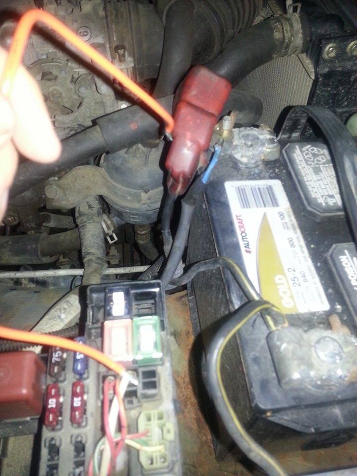

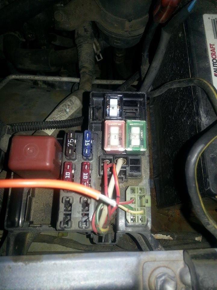

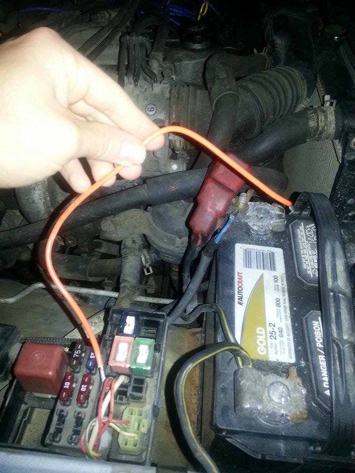

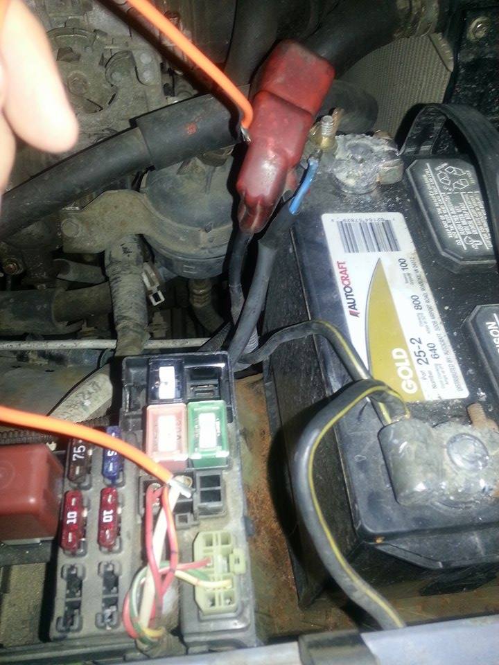

lol well you guys are awesome i really appreciate yals help. I went back out there and after reading what RAD said over 7 times and watching some youtube videos I got up enough courage to go out there and mess with it. I noticed I had spark when I put the cables on the battery and touched them together, so that ruled the battery out. Rad4runner also ruled out the ignition switch for me so I knew it wasn't that. I went and got a little piece of wire and cut both ends off, after touching it on several of the wires I finally got it onto the right one, which I want to call the white wire on the fusebox and then onto the positive on the battery. I noticed my lights came on (you can imagine my excitement lol) I got my cousin to go in the truck and start it up as I touched the wire onto the positive of the battery and booom it started right up. Rad4runner you were right, it seems one of the wires thats leading from that one fuse is either corroded or just not getting the juice to the battery because after I turned it off it wouldnt turn back on again, so I guess I'm gonna have to unscrew the fusebox and see what wires are corroded underneath.

Cool :)
That's the best way to learn. Get in there. Dive in that spaghetti soup* of wires.
See that segment with blue wire exposed? that's the Fusible link wire. Inspect/test that. Also the 80-amp Fusible link module (like a fuse) that it screws directly into.
To remove the module, you need to un-mount the fuse block and work from the bottom. There's a tab taht needs to be pushed out of the way. Terrys87 on Yotatech has a picture.

LOL yea I'd throw courage in there! Trust me I didn't touch the cables too much, I just barely touched them enough to see a bit of spark and that was it lol. Lucky for me my brother in law knows this stuff in and out, so after starting my truck manually with my handy wire lol, I went to his place and we changed all the wires and cleaned up what didn't need to be changed. I also changed both my battery terminals because they were in pretty bad shape. I know first hand how to do this stuff next time if it happens again. You're a lifesaver [MENTION=80771]RAD4Runner[/MENTION] thank you very much for your help. I couldn't have done it without your help.
