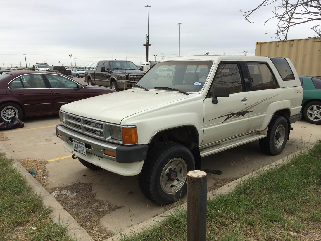

Bought this in the middle of the night. (NOT RECOMMENDED! caught hell from the wife.) from the original owner With a blown head gasket. Has 333,ooo miles...... But still in pretty good condition for its age/miles. Its a fully loaded SR5 with the 3.0 V6......
Going to be a DD/weekend off-roader......
