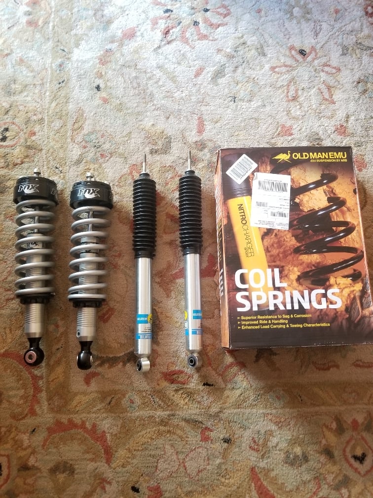

Anyways back to my 2000. It was bone stock with 177k on the clock. I drove it that way for a few months while I slowly collected some parts for it. I ordered rear tundra 5100s, OME 890 rear springs, and bought some NIB fox 2.0 coilovers off of Craigslist for cheap.

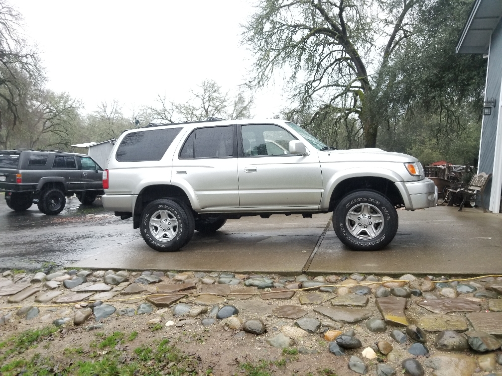

Here it is after I got the suspension on

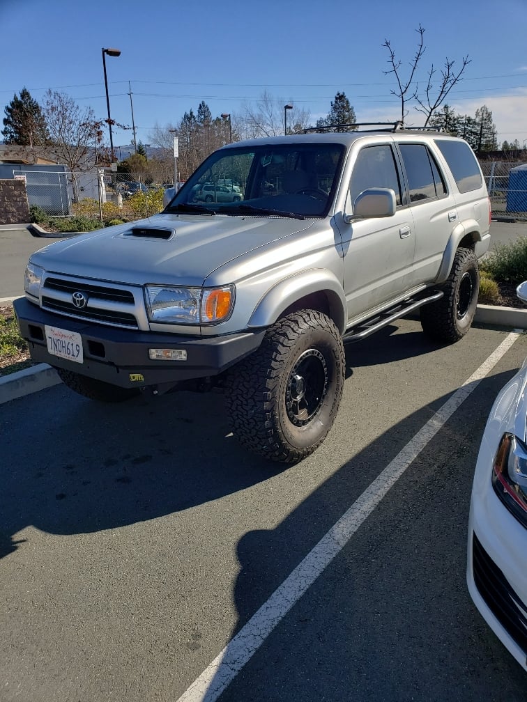

I also adjusted the front coilovers to level it out a bit better. That's pretty much it for exterior mods. Interior wise I have an ultragauge set up with a spiker engineering mount which is one of my favorite mods to the truck. That's really it for interior wise for now lol
How she sits now

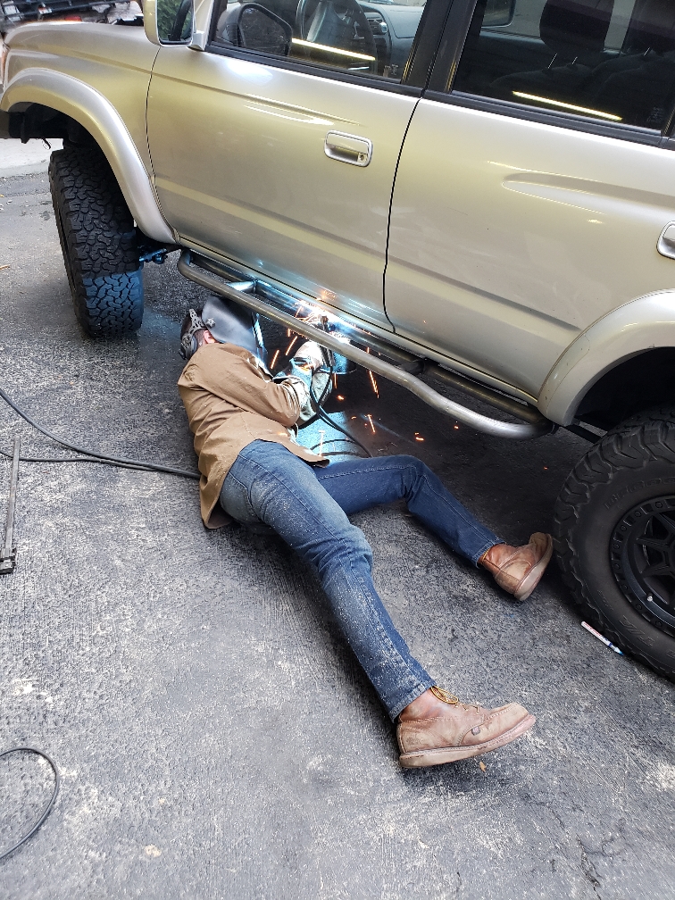

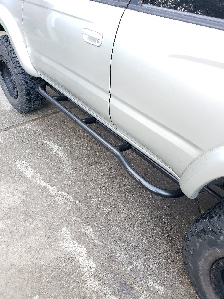

Over the last weekend I got my 4xinnovations sliders welded on. My girlfriend got these for me for Christmas so it was nice to finally have them on after sitting in the garage.

How do you like the ride on the Fox and Bilstein combo?
The Foxs ride like butter. The bilsteins and OME 890s ride decent, a little stiff with no weight. I can definitely tell the front is more controlled compared to the rear but when I have the truck loaded up with weight it feels a lot better. I'm hoping that when I get my rear bumper and tire carrier, it'll help make the rear more plush. But eventually I will make the switch to Foxs in all four corners.

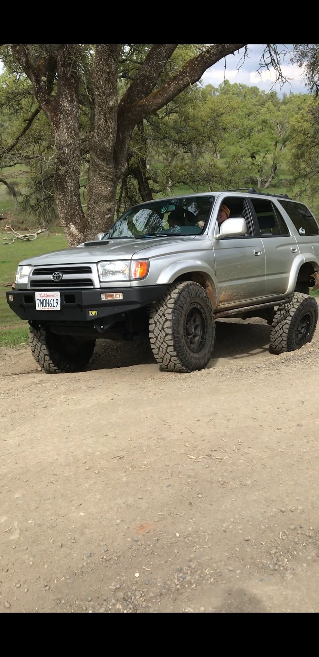

Did a thing today
today

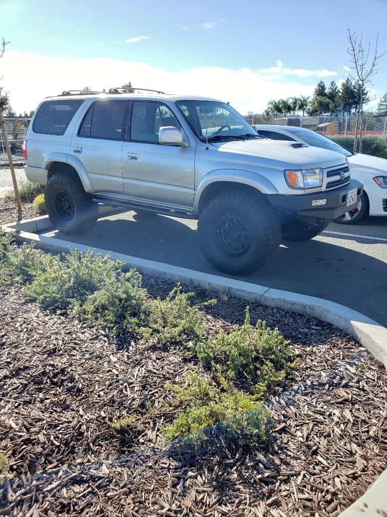

Honestly, i think they're too big. They dont rub terribly, but with the lift I have, the wheel wells look stuffed. Ordered a set of 285/75/16 Duratracs to swap out. I'll come back to 315s when I get gears and adjust the lift some.
Sent from my SM-G965U using Tapatalk

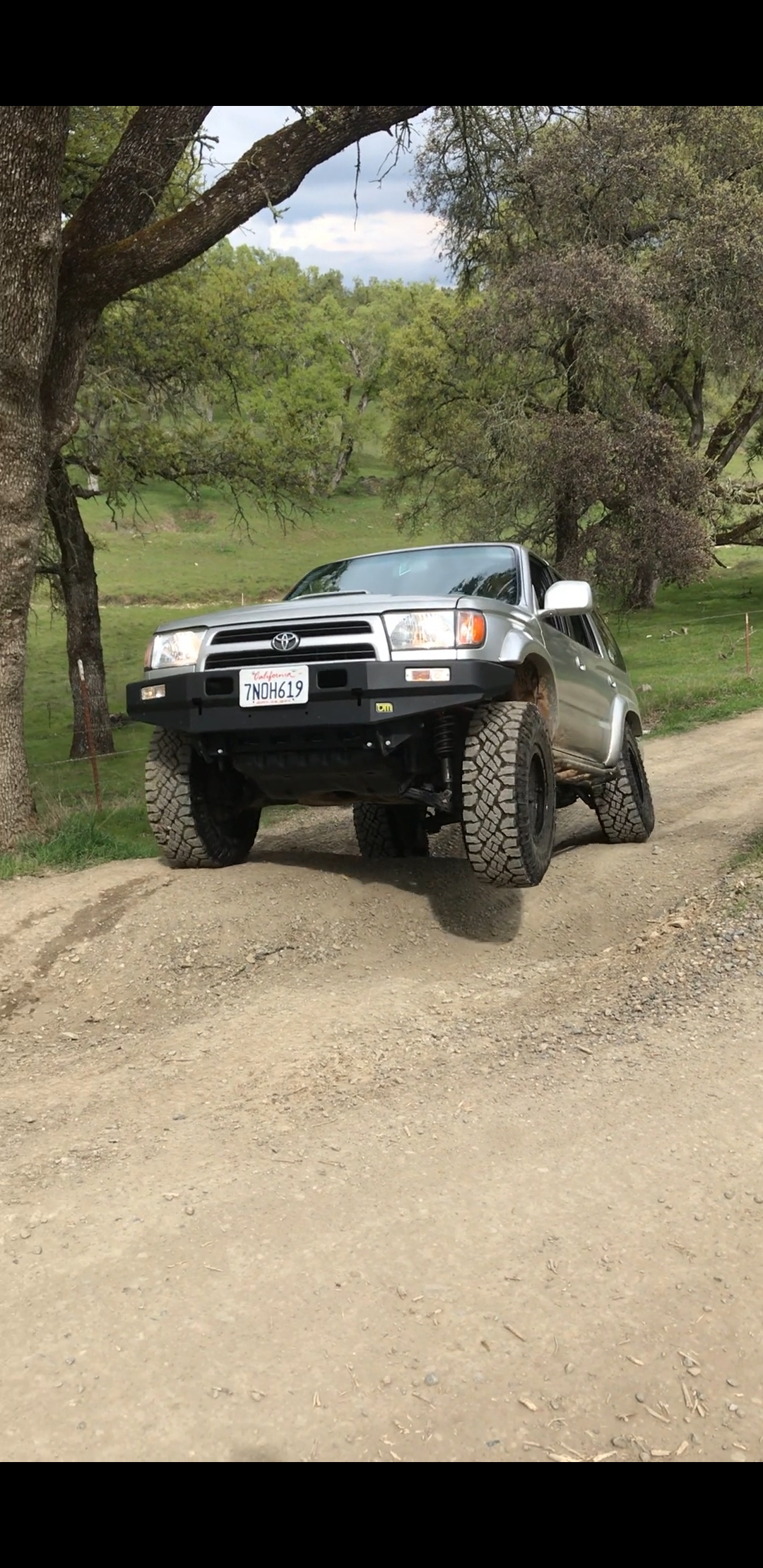

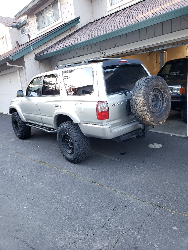

Got the duratracs mounted a couple weeks ago. Trimmed some plastic and no rub at just under 2 inches of lift. They will rub the pinch at flex so next time I have a garage space I'm gunna do some cleaning. Overall very happy with them. I honestly can hardly tell only a little difference in power. 4:30s turn them just fine for me. Ride quality is vastly improved over the 265 K02s.
Also replaced sway bar bushings and bought a detours tire carrier.

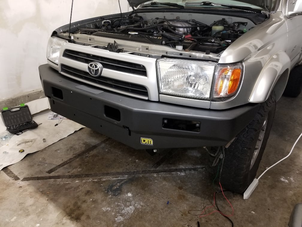

Very nice looking rig. I just ordered the same front bumper and was wondering when lights you have installed for the turn signals? Thanks.
Thanks! I used the turn signals that tjm supplies with their bumper! Just spliced two wires each side.

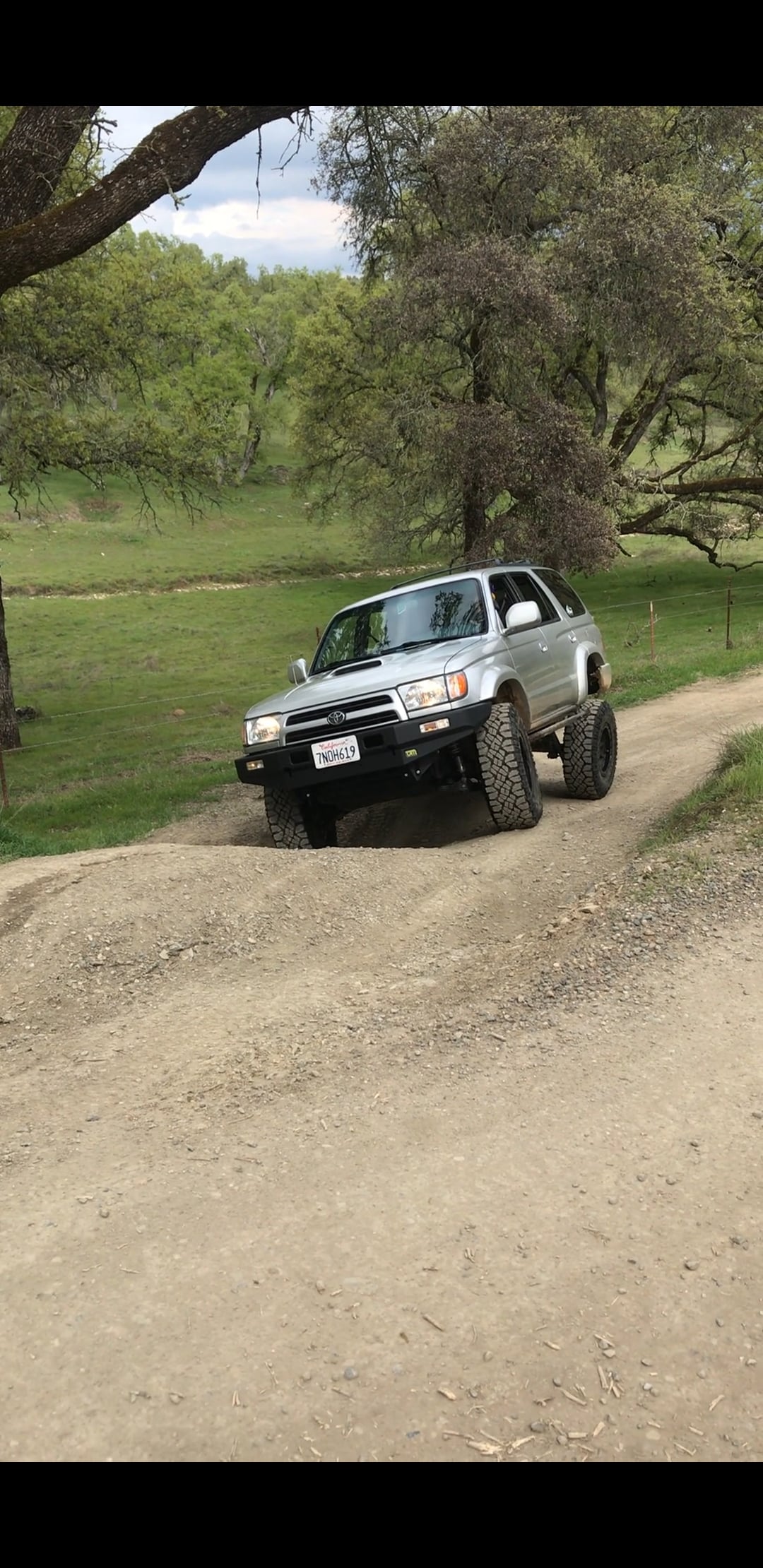

Broke out of quarantine to take the family on a quick drive down Old Latrobe Road. Got a little flexy on one part of the road.

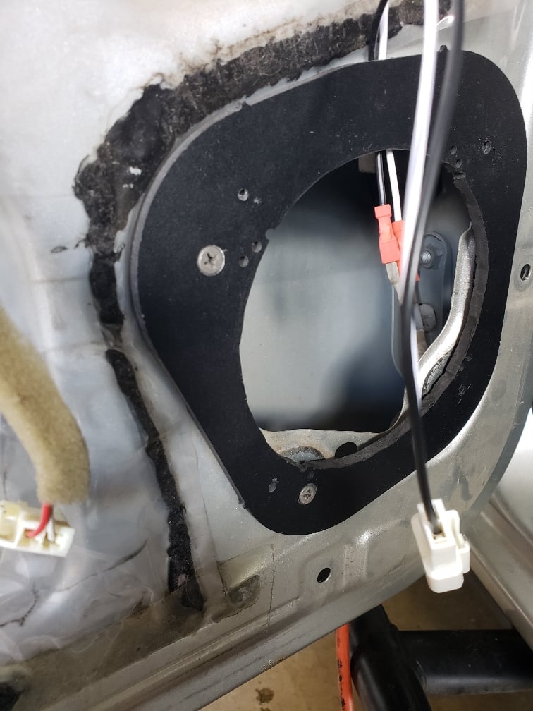

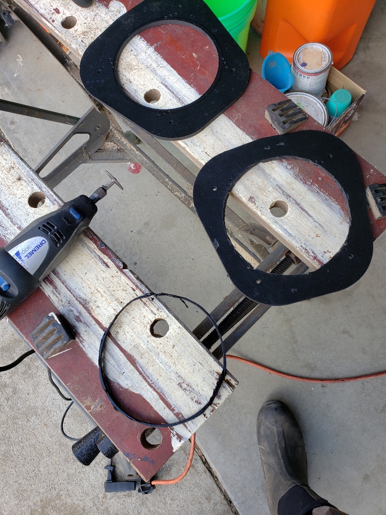

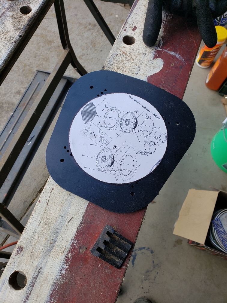

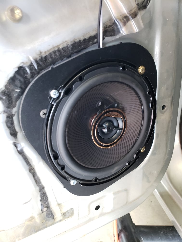

Also changed the oil and installed some 6 1/2 speakers in the rear doors today. Best Buy had Kenwood KFC651s on sale for 37 bucks and with a mounting depth of 1.9 I figured they'd fit great.

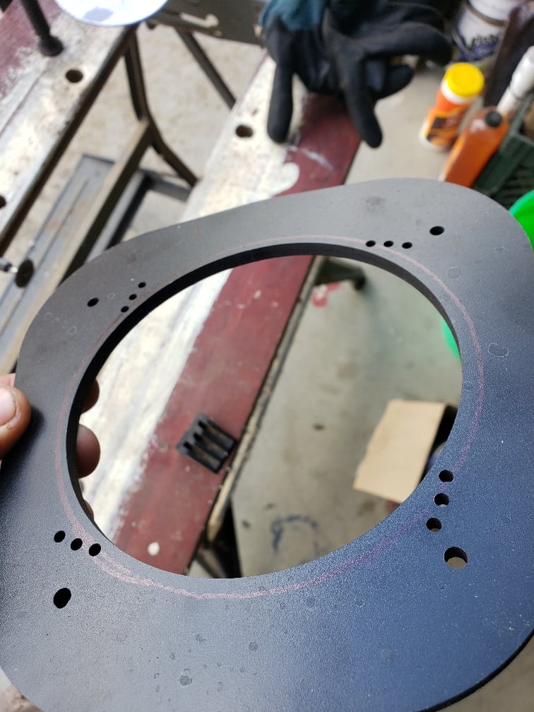

I ordered some 5 1/4 speaker adapters off of Amazon and used the cutout on the back of th speaker box to trace where I need to enlarge the hole of the adapter.
I used a dremel with a cutoff wheel and cut along the circle.
I used two of the screws that hold the adapter down to also hold the speaker. The other two screws (adapter to door) I countersunk so the speaker would lay flat. Then I drilled two new holes for the speaker to adapter screws and put it all together.
I used a Metra speaker wire adapter so I didnt have to do any soldering. I did have to dremel a channel on the adapter plate for the wires so they wouldnt be pinched. All said and done it took maybe an hour and a half for both sides and everything clears with plenty of room! Suuuuuper easy to do as well!

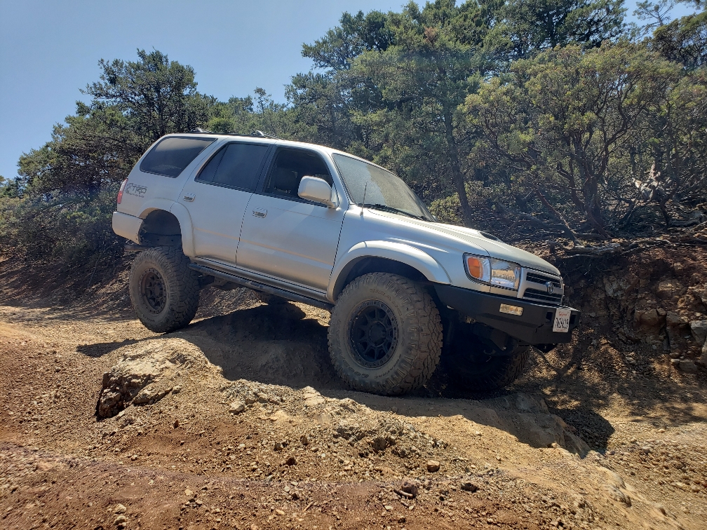

Spent memorial day at Moonrocks with friends! Towed my bike and all my camping gear over the Sierras with no issues and good tyranny temps. Didn't really do any wheeling just dirtbiking and riding in my buddy's rock lizard.

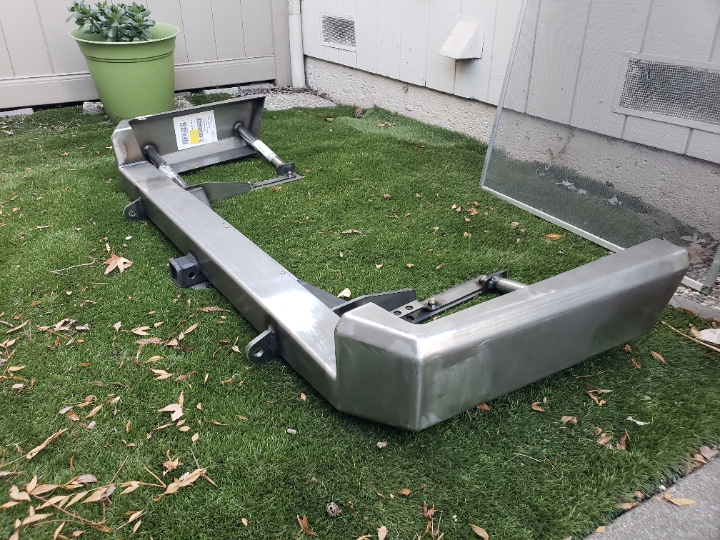

Last thing, after waiting 8 weeks my 4xinnovations bumper finally arrived and I just dropped it off today at the powdercoaters! I'm matching it to TJMs factory powdercoat ( black with a little bit of texture). I should have it back in 2 weeks so I'll update this thread once I get it installed.
