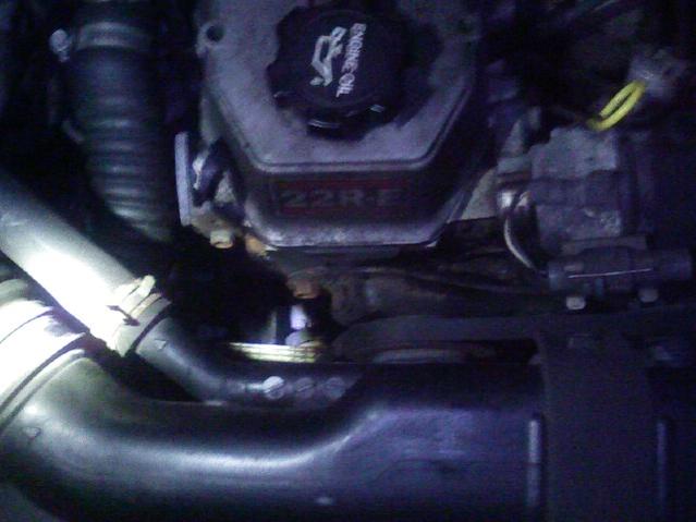

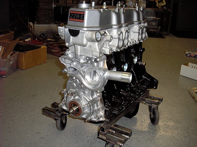

The timing belt cover you have to remove is NOT the valve cover. It's a plastic cover on the front of the engine. It should just be held on by several bolts (low torque). I don't know what the 4-cylinder engine looks like, but if you take a picture of it, we can show you what to remove.
Thanks lakeRunr, I don't know if this picture will be helpful. I'm sure this is just a coincident but yesterday I took it in for oil change, this morning it started up and I went inside to let it warm up, but when I came out it wasn't running, looks like it never ran long because the windows were still frosted. I checked oil it looks fine.
