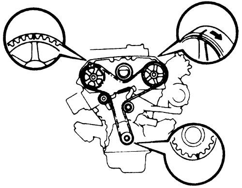

You need to take the belt off, but not the lower crank pulley or cover. First, loosen the idler pulley bolt, and spring if you must, slide belt off the top two pulleys. With a ratchet or wrench, turn each cam pulley clockwise until mark on pulley is at top. You should see a mark behind the pulley at top. Once both are where they need to be, take the right side of belt, between crank and right cam pulley, keeping it as tight as you can and pull it over the right cam pulley, then bring it under center pulley, then over left cam pulley, then down behind idler pulley. Make sure at this point that all marks are where they need to be, push the idler pulley to the right with a block of wood to tighten belt, then tighten bolt on idler pulley. Let me know when that is done. Do Not Start Yet.
the left cam pulley is at about 6 o'clock and the right cam pulley is at about 4 o'clock
Does this help? This is a attachment from Autozone.
