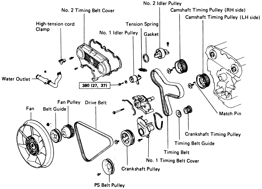

Maybe this will help.... This attachment is from Autozone;
Only the #1 idler pulley, tension spring, and #1 timing belt cover needs to be removed. Also, buy a new seal for that lower timing belt cover to the oil pan. Good luck to ya.

Correct. If you look at the pic, there is a seal that is u-shape, that goes underneath the cover to the oil pan. you'll se it on the bottom side of the cover when you take it off.

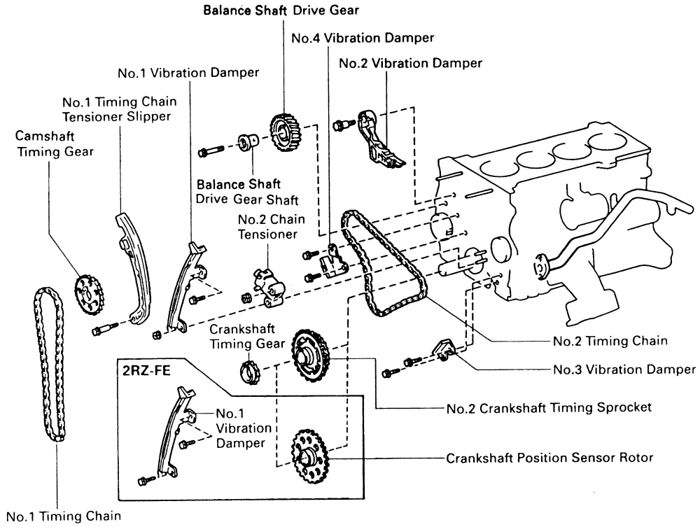

I don't know if this picture will be helpful.
Sorry, I don't see what I was expecting to see in your pictures. The 4-cylinder must have a different arrangement. Maybe Davesdetail can pull up the AutoZone exploded view from your engine.

Well, I hope this 4- cylinder set-up can help Noggie out. This att. is from Autozone. Cheers Guys.
