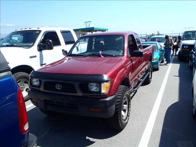

and here is the taco thats gone

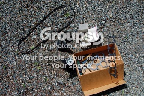

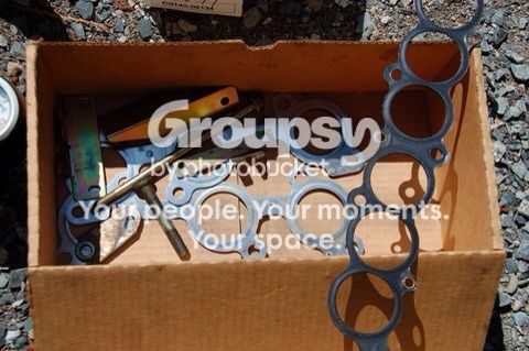

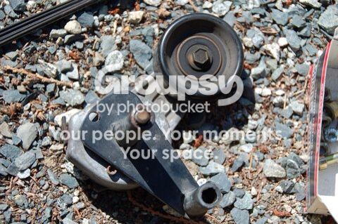

Okay guys here the photos. What do you think/see? I won't have money for the 7th injector for awhile and I've read mixed reviews on whether it's okay to install without it..
