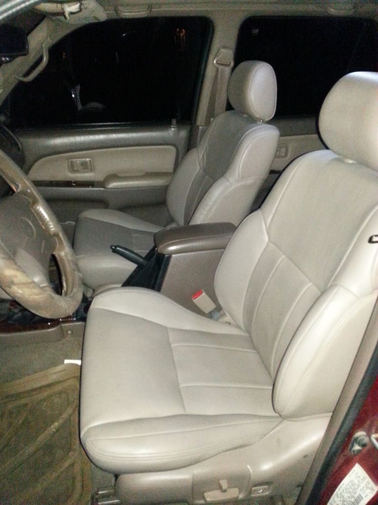

After being quoted almost $600 or more to fix and cover the seats I just went with some synthetic covers. THey look good, cost me $179 shipped, here is the thread I made, was going to post some better pictures here soon one I cleaned the truck. Also about to buy a new carpet for the floor pan here soon.

I went with US Auto genuine leather replacements, both upper and lower for the front seats in Oak. My back seats are in terrific shape. They also sold me new foam lowers for both seats. I carefully pulled the occupancy sensor off the passenger side and used contact cement to apply it to the new foam. While I was in there, I added a seat heater kit from Amazon.
This is probably the best money I've ever spent on my 4runner. I want to keep it mostly OEM so it was worth every dime. US Auto's Oak leather is a spot on match to the original color, even though it looks too tan/yellowish in all their product shots.
It's a little labor intensive, but easily a DIY project. The new foam in the lowers makes all the difference in the world. So much so, that if they ever start offering the uppers, I will consider tearing the tops back apart and installing the new foam.
As someone said, rebuilding these seats makes the truck ride like a new one again. You'll laugh the first time you climb in and realize how much of a lowrider you've been all these years. :car:

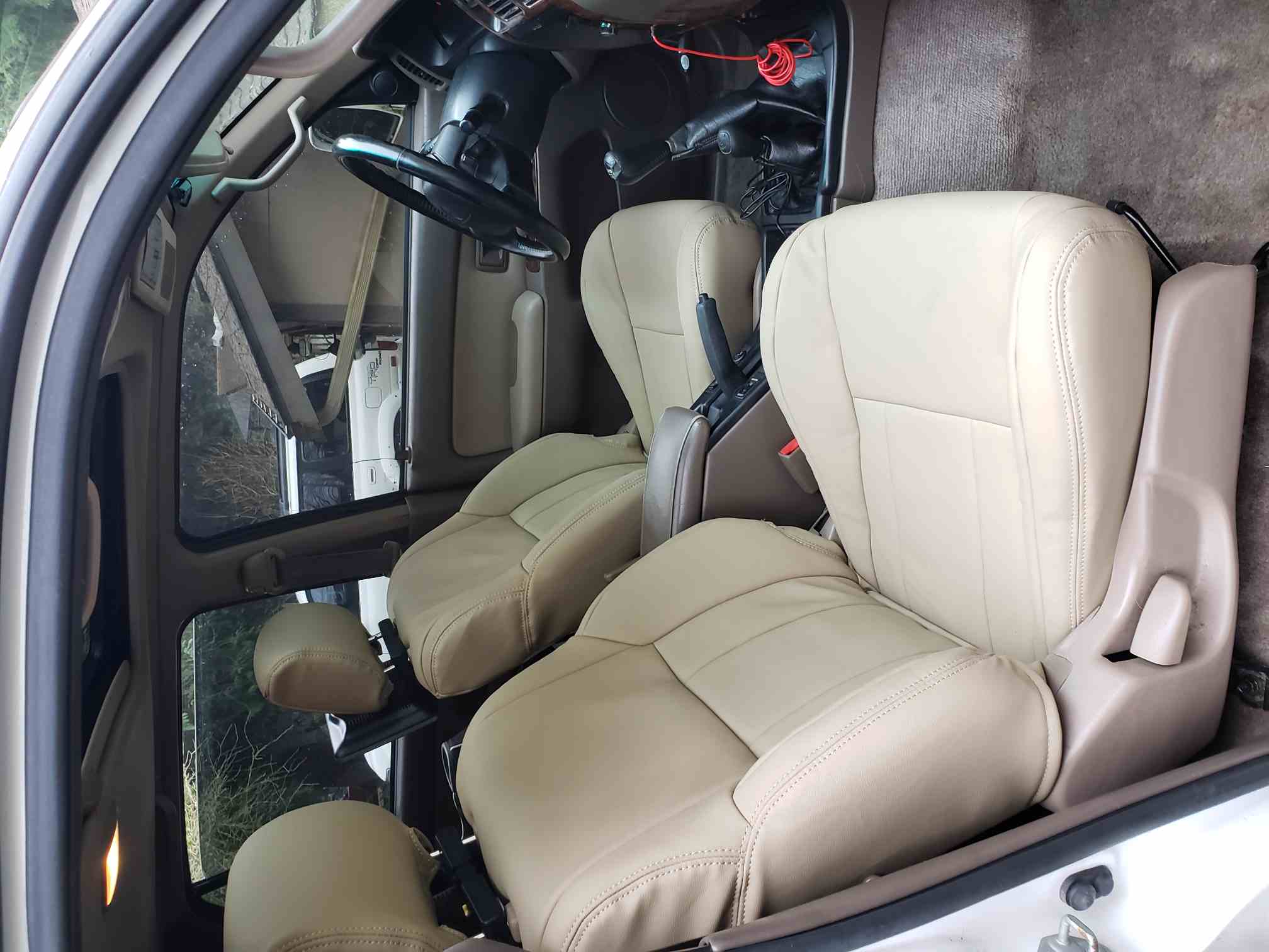

We did Lseat covers (not a perfect match in color but I've grown to actually prefer how they stand out) and added aftermarket dual temp long seat heaters. Better than any stock heaters I've ever had. We had a set from our SR5 and lower mileage limited - so made a best set of manual seats to go into the limited.
We did the work and all in all cost around $400.
