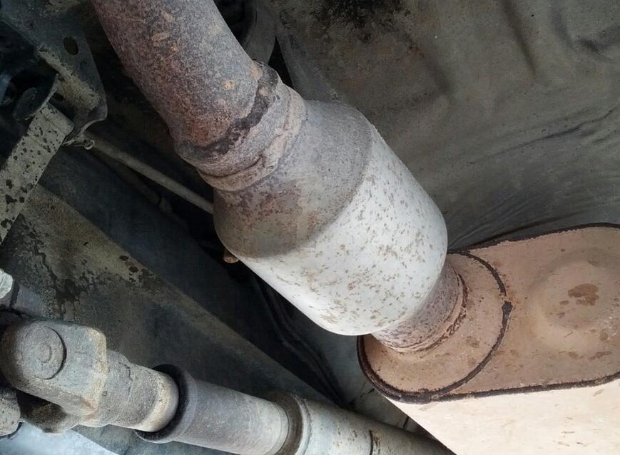

What it does is eliminate the DRONE while retaining the throaty sound.
The Tundra resonance silencer is a stock part but you can install a used one like I did. Most muffler shops just throw them away. Weld it directly behind the muffler. The nice cat back exhausts like Borla come with a similar part welded in line.

The Tunrda resonance silencer mod is something I owe to my mechanic after I complained about the drone. He welded in the "factory resonance silencer" just behind the muffler (about 1") and WOW it still sounds awesome and deep but without the HWY drone.
The downsides are you will have to find one at a junkyard or muffler shop. I have a used one, there is no need for it to be new.

Yes I was talking about what Tundra generations have it not 4runners.
My mechanic picked it out of a junk pile at him shop.
I assume it is the generation from about 2000. Not the newer gen.

I think it sounds badass AND the HYW drone is seriously reduced.
