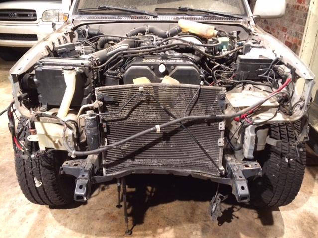

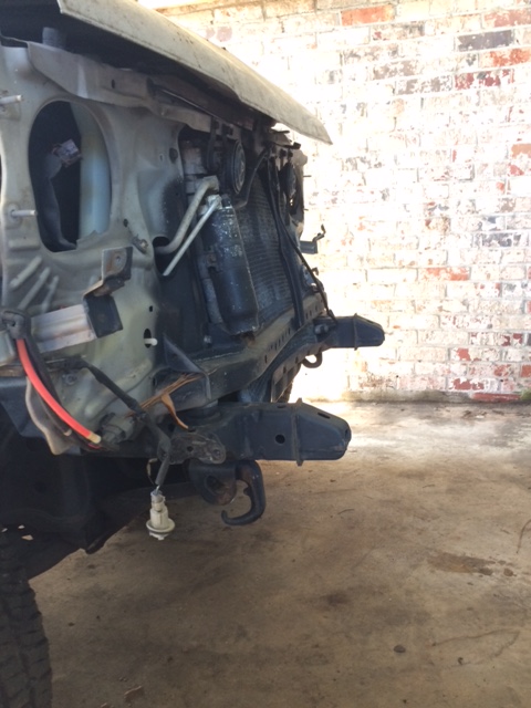

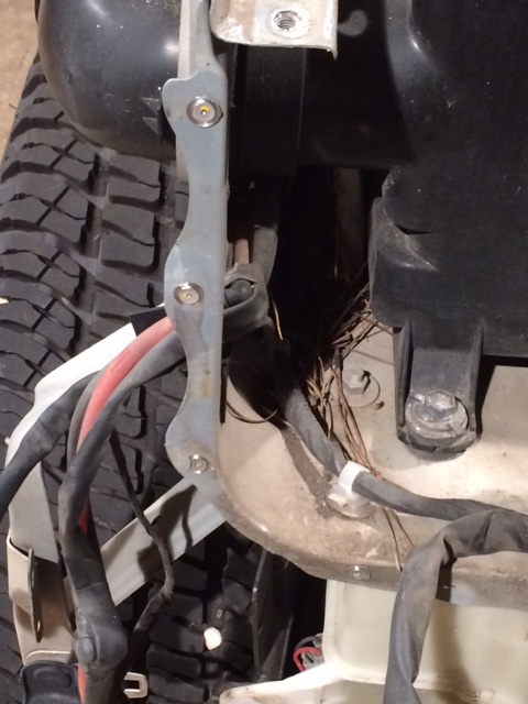

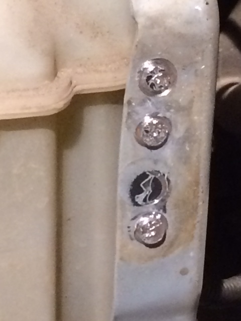

I'll get a couple of pics in a little while, but the core support is completely off the truck now:biggrin2: I actually used a spot weld cutter instead of just drilling through so I still have solid sheet metal to attach the new core to. I used a cut off wheel to make a slot in the old support so it could be removed w/o venting the AC system. My condenser is deformed enough that the right thing to do is to replace it and the receiver/dryer and have the system evacuated and recharged. I was hoping to avoid that since I've still got ice cold air, but that would mean cutting the new support to install it and then tacking it back together. It could definitely be done, but I think it would be an amateur move to do it that way. I guess I'm about to go ahead and order the parts. I really don't want to have to hide my work because I did a half ass job. AC parts included, I'm still going to be about $4k better off than replacing the truck.....and I get to keep MY 4Runner that I've been driving for 19 years:lookout: It may be old, but it's MY old 4Runner!

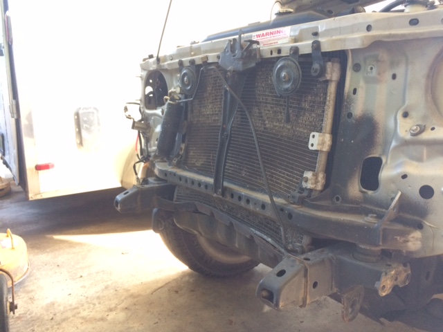

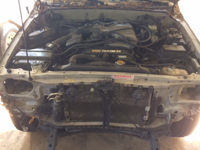

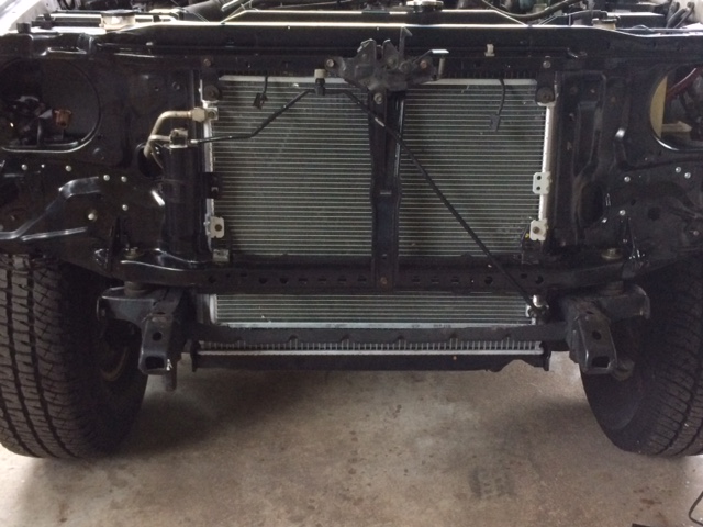

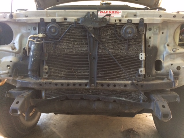

Here's a pic of the front w/the core support removed. The other two pics are what's left after cutting the spot welds. All I have to do is grind the spot welds flat and I'll have good sheet metal to mount the new support to. I'm glad I took the time to do it this way instead of just drilling them out. I did go ahead and order a new condensor/receiver drier/o-ring set. The pictures show how much deformation the condensor has. Having it out is also going to make replacing the cross member under it much easier. The picture makes the lower support look worse than it is. There's a donor w/a good one at the local pull-a-part.

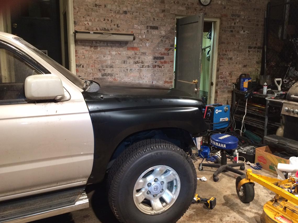

I'm not completely out of the woods yet, but have made some progress. Got the the new core support in and the hood and right side fender mocked up. It's going to take a little tweaking to get everything perfect, but I think it's gonna work out ok. Picked up all the paint today. If I can test fit the other fender tomorrow, I may be able to shoot paint late tomorrow afternoon.

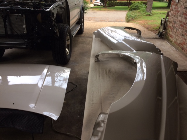

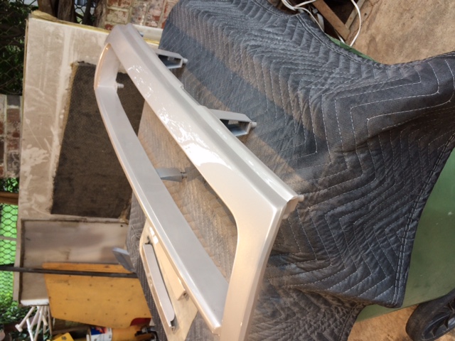

Finally making some real progress. Got the new core support in and the A/C back up and running. Got the fenders, hood, and grill painted today. New OE LBJ's came in today and I'm going to install those before I put the fenders back on. Hope to get them done and the new bumper painted tomorrow. If I don't hit any major snags, I should be back on the road in a week or two at the most.

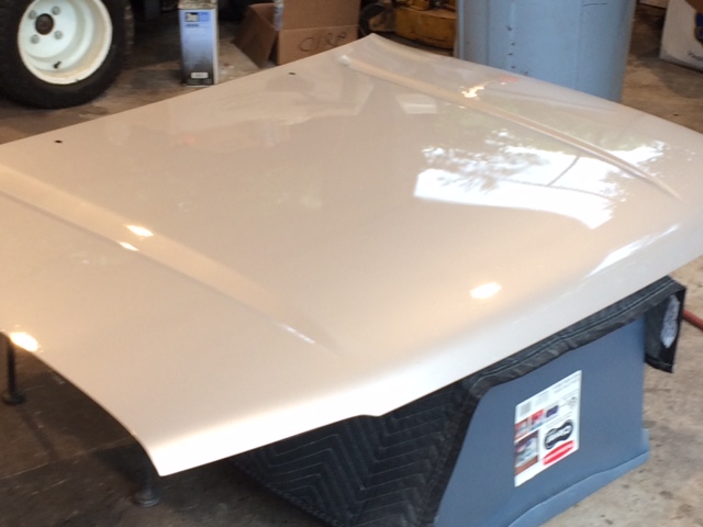

I appreciate the compliments. The paint looks good, but will look way better after sanding/buffing. Spraying in the carport invites lots of dust and small flying critters. They're not too bad when you're shooting the base coats, but they come from miles around as soon as you shoot the first sticky coat of clear. My rear bumper didn't get damaged in the accident, but since it had a few trailer dings I figured I'd go ahead and put a new one on since I already have to paint the front. You probably can't see it in the pics, but the grill is already cut and prepped for a Satoshi mod. The perforated metal is already done and I've got the Toyota emblem for it. Bigfishallday's color matched grill looked so good that I decided to do mine the same way. Since I don't have fenders mounted, I think it's going to make doing the LBS's much easier. You dont realize how cramped the fenders make things until they're out of the way. As much as I was looking forward to getting a new truck, I think I'm going to be MUCH happier having MY truck back.

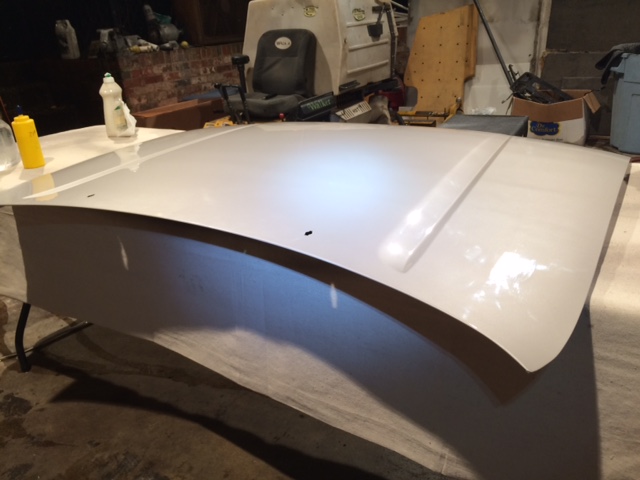

I almost did! The only reason I didn't was that (other than looking very cool) it doesn't actually do anything and it looks like a good place to catch bugs on the road. Now that it's mostly done, I do wish I'd done the Tacoma front end swap. I didn't know exactly what I was getting into and was concerned that gathering all the right parts might be confusing. In retrospect, it wouldn't have been any more difficult and I like the ones I've seen done. I'm about to go sand and buff the hood and do the LBJ's. The hood is sturdy enough to work on off the truck. The fenders are pretty flimsy until they're mounted.

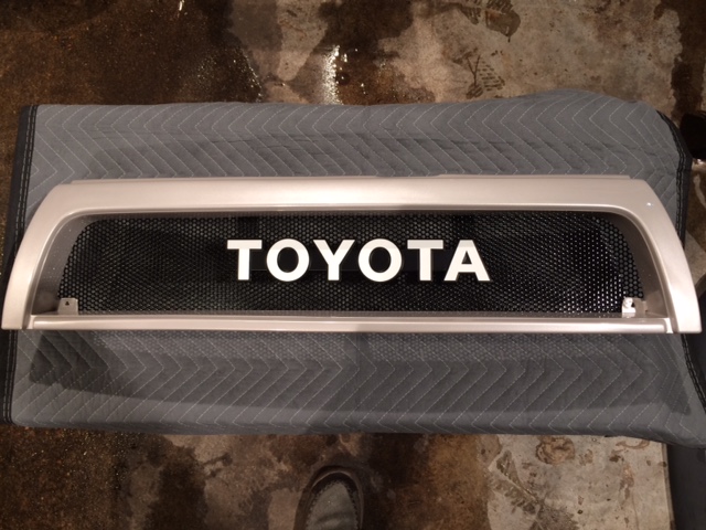

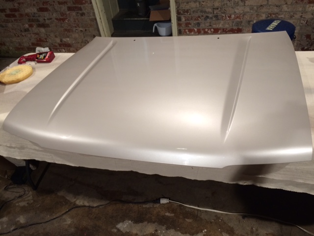

So much for my big plans. I decided to go ahead and buff the hood. That went well.......slow, but well. Sometime in the middle of buffing, the the weather decided we'd get two inches of a 15% chance of rain. With a river flowing through my carport, I decided I didn't need to install my LBJ's bad enough to crawl around in the water. Instead, I got the perforated mesh painted black for my take on the Satoshi Grill. I need to paint the front side of the lower two grill mounts black so they don't show. The hood paint is good, but I've done better. The spot on the front edge of the hood is just the light. Also, the grill is not assembled. I just set it on a table to get a pic. Not sure if it's true to the Satoshi name, but I like the way it looks. I started to go ahead and install the hood by myself, but I figured there was a fair chance of scuffing it up. I'll wait and do it tomorrow w/an extra set of hands. Everything ALWAYS takes longer than I think it will.

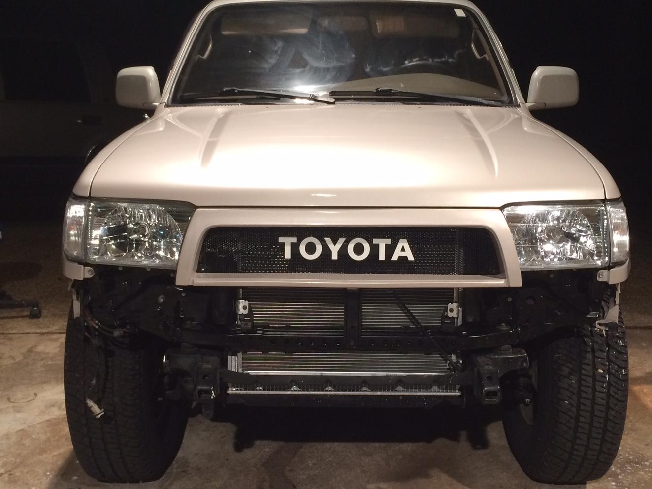

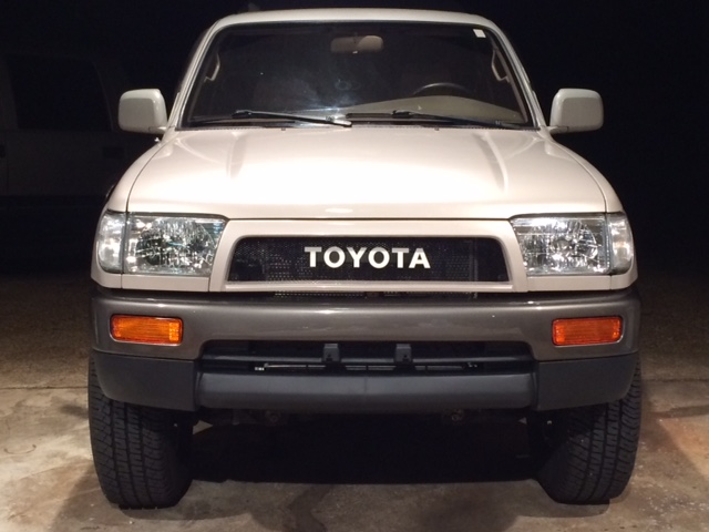

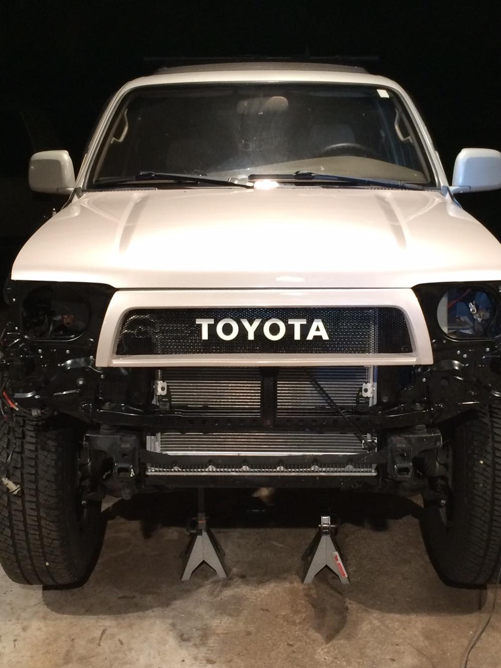

Got the hood mounted and stuck the grill in place just to see what it's going to look like. Went ahead and did the LBJ's while the fenders are off. They went easily, but I definitely need OTRE's so I'll be swapping those tonight. Here's a of pic of the grill on the truck. It's not actually off square; just lightly stuck on to look at it.

Great progress! Glad you decided to fix it up. Did you buy that grille already painted? I really want to color match mine.
I had to replace the grill anyway, so I just bought an aftermarket from Amazon. I prepped it for the mod and shot it when I sprayed the hood and fenders. It came dark metallic gray. I saw a pic from Bigfishallday where he matched the grill and it looked good so I decided to try it. It'll be interesting to see how it looks w/the metallic gray bumpers once I get them painted.
Charles
FWIW, Matt at CustomCarGrills.com does great work and is a wealth of good info and is an all around cool cat. I did my own, but I wouldn't hesitate to use his pre shaped grill material. He's pretty much got the grill thing figured out.

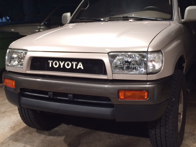

Slowly but surely its coming together. It's not showroom flawless, but I think it's looking pretty decent. Got the evil under headlight filler panels installed. I managed to get the front bumper sanded and buffed and installed. I was fortunate to have what's left of my old bumper so I could get all the hardware for the lower valance. The bumper came with two funky brackets in addition to the main brackets. I'm going to have to find a pic or a diagram to figure out how that goes together. I've got o reinstall the skid plate, plastic fender liners, and the flares and it should be pretty close. I'm still kind of leery about using LED bulbs in a reflector housing so I'm running Hella 80/100's aimed a smidge low. They're not HID bright, but the high beams are pretty decent. I took it for a good drive tonight and it feels so good to be in MY truck.
