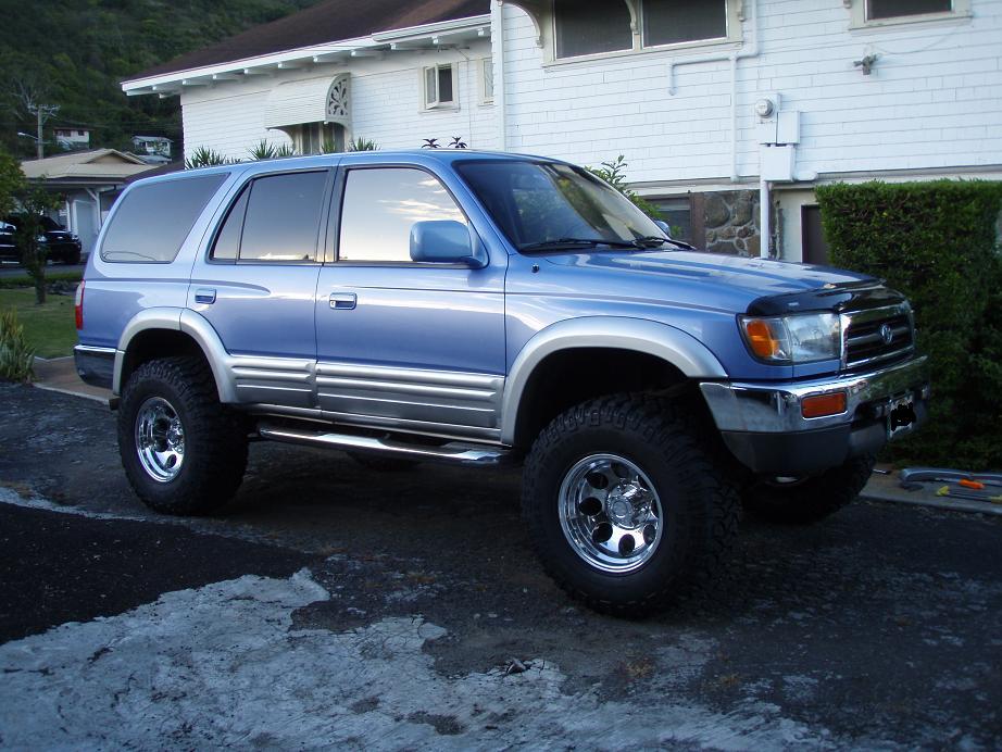

After much deliberation I finally pulled the trigger on a new set of wheels and tires.
Installed the lift about 4 months ago (2.5" Daystar).
Here are the details:
Wheels: 16 x 10 ProComp Extremes (real cheap)
Tires: 305-70/16 Mickey Thompson MTZs
I had to trim the plastic lower front bumper valance and some front fenderwell liner (on the rear of the front fenderwell) to avoid the rub at full lock/full compression.
Enjoy!

Thanks for the comments!
Jhabit, that is an awesome looking rig you have. What kind of racks do you have? I'm looking for a set for mine.
Aloha!
Thanks uluafishing. My racks are made by YAKIMA, and they have WRV surf pads on them to fit more boards. I like the look it gives to the ride also.

I have 5% tint on all the back and just a shade lighter on my front sides and I've never had an issue at night since it's not as dark looking out as some assume. If I need to see out the back in some cases I just roll the rear window down.
No wheel spacers required.
I did my buddy's '98 Runner and his is an inch taller (lucky he has the 98). He's running 285/75/16 BFG AT on 16 x 8's.
I'm really enjoying the performance of the MTs!
A little stiff in the ride, but worth it.
