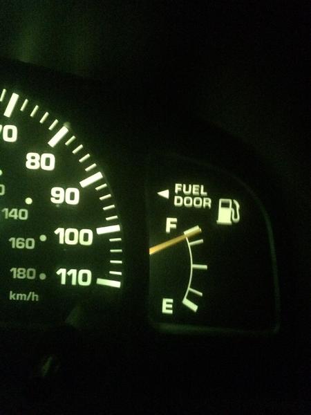

Drove the truck for ~250 miles. That's about on par with where the fuel gauge was reading and got stuck originally. Then all of the sudden while driving, bam!, my fuel gauge starts climbing to more than the level should be after 250miles. I took a snapshot of it real quick. (Pic. A)

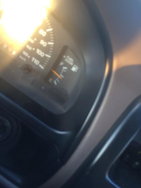

I pump and pull up to a Costco after two minutes of being on. And I look at my gauge and its stuck at a lower level. (Pic. B) And I said oh well, it was probably a fluke.

(Pic. A)
(Pic. B)
