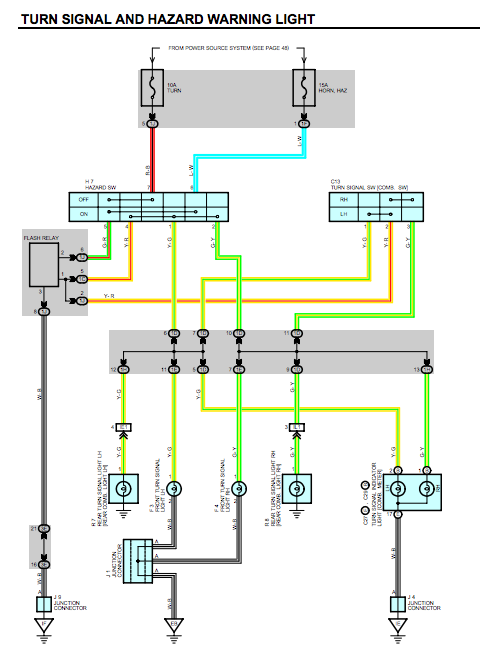

Trying to track down the wire for the left hand turn signals on a 98. The wiring diagram I (and probably many of us) have is for an 02, specifically this page:
And this AutoZone diagram might not be accurate either--I can't find a Grey-Black wire in the floor wire runs (or a Yellow-Green).
Anyone have an authoritative source? Any help much appreciated. The 1998 version of that diagram above would be a huge help.
Eh, nevermind, I was able to sniff it out by looking at the hazard light harness and poking around with a test light. Took me longer to make the post than pull the center console off and narrow down the candidates.
It's Green-Black, if anyone is ever curious.
