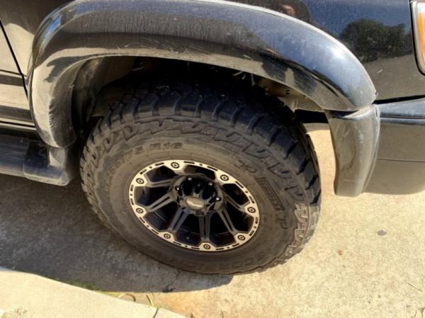

I just put a set of LT 265/75/16 Duratracs on my winter wheels and they're unstoppable. Especially seeing that I had them studded for ice driving pleasure. Plus they look pretty badass.
Pardon the crappy picture.

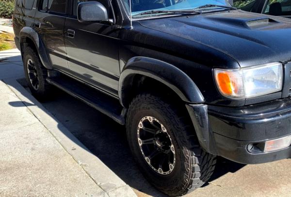

2000 SR5 with Pirelli Scorpion MTR 265/75/16's, had to do some minor trimming to the running boards but I'm eventually taking those off.
