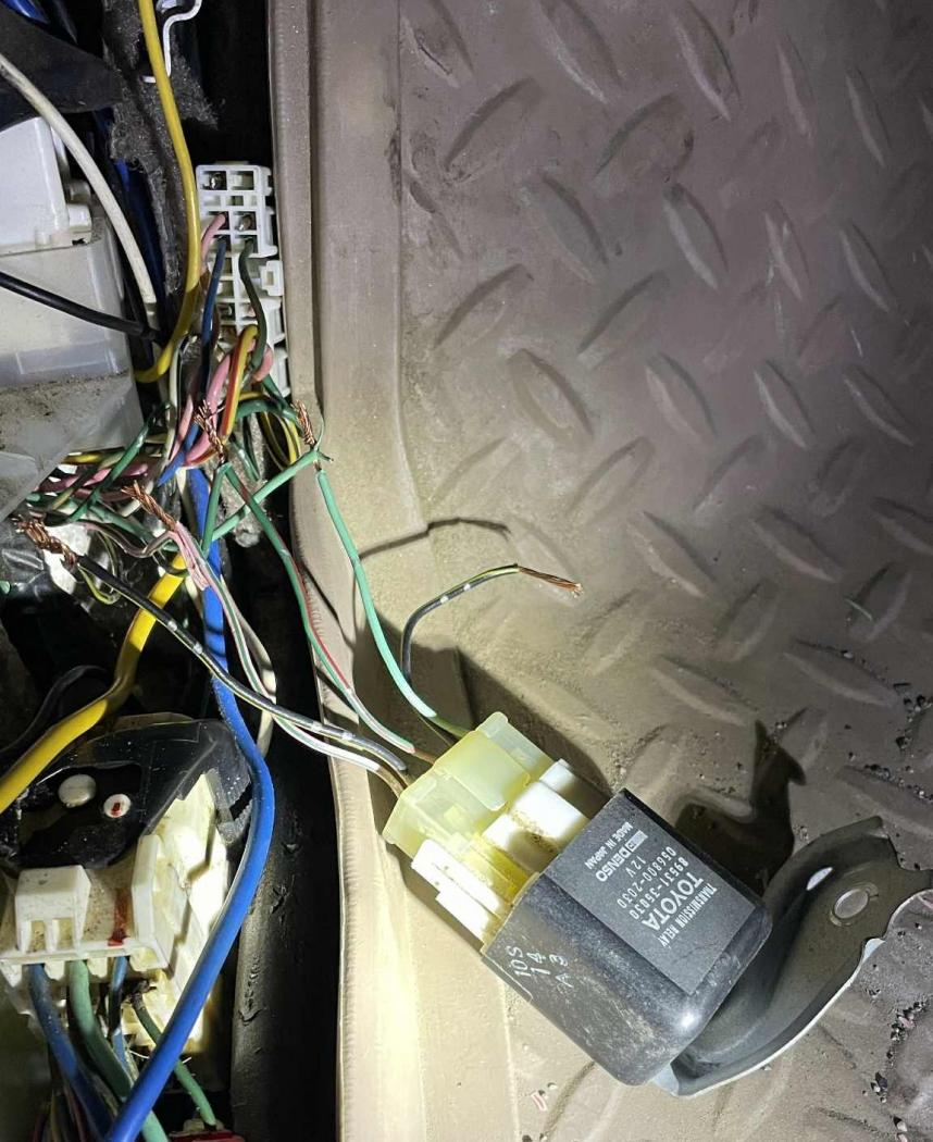

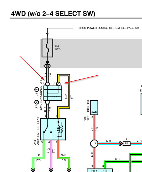

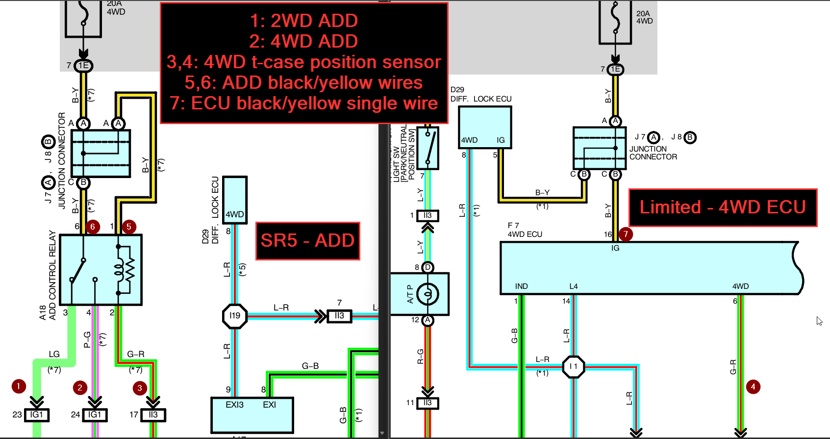

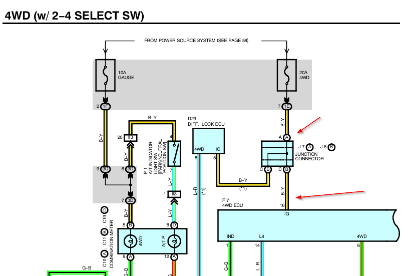

The '96-'98 clusters are all the same (only engine/trans different, not by trim - though they do vary by year also) since the Limited case is not AWD. Just one 4WD light, like the j-shift case.There are different clusters between the SR5, Limited, and limited with AWD.
The Limited dash wiring is different than the base/SR5 wiring. The Limited has a computer in the driver's footwell, the base/SR5 uses a 'simple' relay in the passenger footwell.

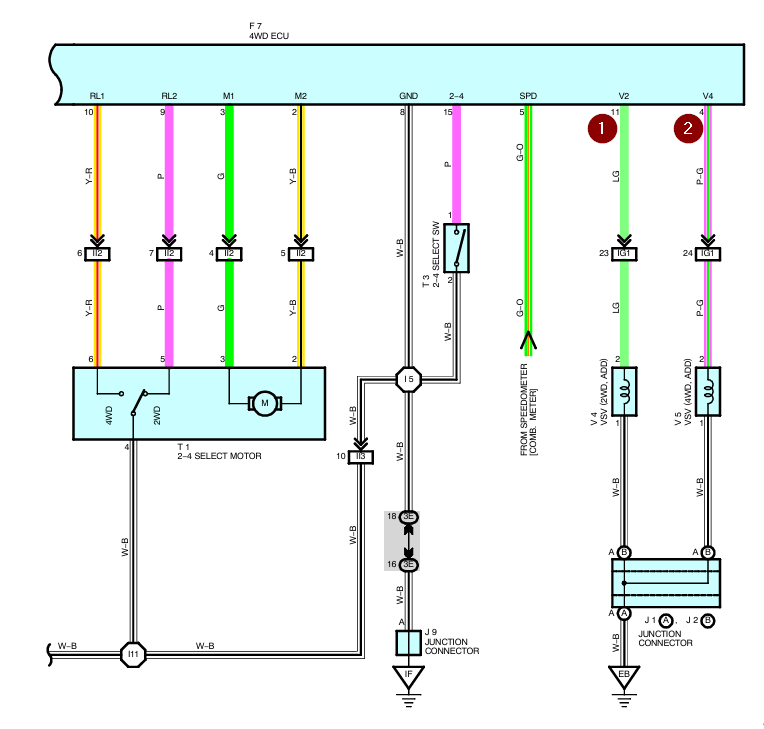

There's some challenges here - do you want to swap over to the SR5 control style? Do you want to try to use the 4WD computer? In either case, there are some challenges...
Even the j-shift has to actuate the front VSVs and uses a few detection switches to drive the dash light.
