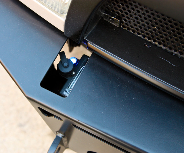

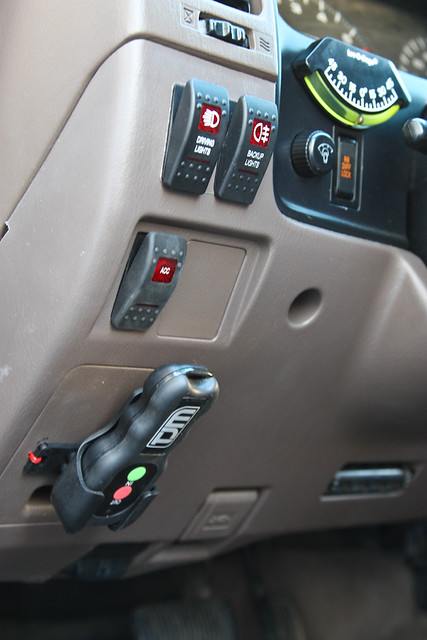

I got a few things done over the weekend. I mounted my wireless winch controller inside the truck where I would have easy access to it; whether inside or outside of the 4Runner during a recovery. I also wont hit my knee on it in this location and accidentally "bump" the winch in/out.

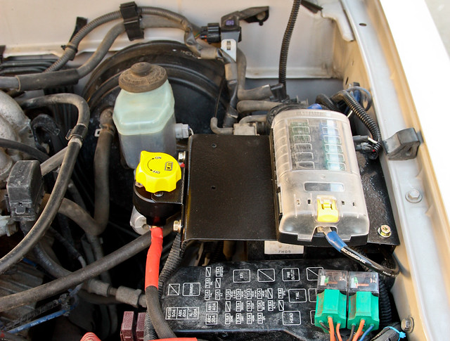

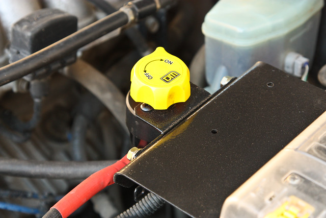

I then made a new bracket for my aux. fuse block using steel instead of the old one which was stainless. I just found the stainless to be a b**ch to drill through when I wanted to ad new relays and I wanted to make the bracket a little different this time. While I was there, I also mounted my battery kill switch for the winch. I leave it OFF when I'm not on the trail so there can never be accidental winch operation or any kind of possibility of shorting out the winch.
20121021-IMG_3136 by RickaShay24, on Flickr

I had to remove the solenoid box from my TJM winch in order for it to fit inside the bumper. I made my own extended wire for the solenoid box using 2-Guage cable. The original TJM wires were extremely short and not flexible so this is a must-do with this winch if you plan on re-locating the solenoid box at all. I then made a small bracket out of a piece of L-channel and mounted that to the bumper. Here is where the solenoid box now sits, giving me easy access to the winch controller plug, should my wireless remote battery die out on the trail.

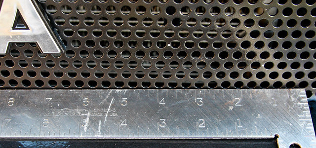

I've had a few questions about the mesh I used for my Satoshi grille. I actually was given the mesh from a buddy so I am not sure where he got it but here is a close-up if you want to know the size and spacing of the holes:
20121021-IMG_3142 by RickaShay24, on Flickr
I do know that these guys have a large selection of grille mesh though: http://www.customcargrilles.com/

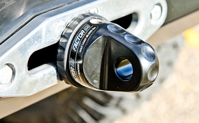

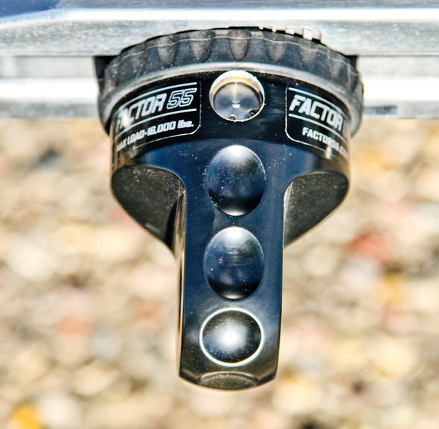

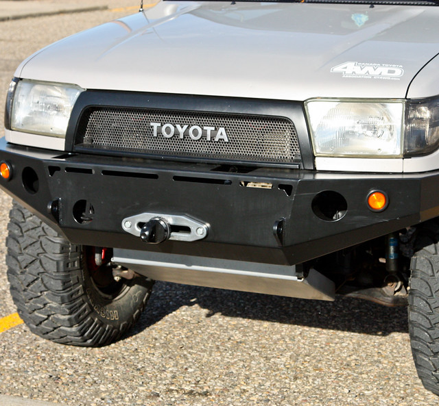

I bought a Factor 55 Prolink for my winchline. It's a pricey piece of equipment but I really was not a fan of the big bulky hook that came with my TJM winch. This thimble is a work of art, you have to see them in person. What sold me on it was that I did not have to re-splice my line to put it on like the Viking thimble. Plus, I can pull the Factor 55 off and use it on another winch if I ever were to sell the 4Runner or wanted it for another vehicle (heaven forbid.... lol). The rubber base is a nice touch too, for snugging it up to the fairlead.
Pics: I really should have cleaned it before taking pics!

Keeps the front end clean and the winchline hella-tight, IMO:
A friend of mine sells those and they are REALLY nice pieces, yes they are pricey but you get what you pay for right?
Pro Link Shackle Mount

That thimble for the winch line is pretty sweet. I saw those on TRDParts4u, but no way in hell I can justify $150 for that thing. If anything, I'm on the lookout for a bigger winch hook.... what's the deal w/your old one?
