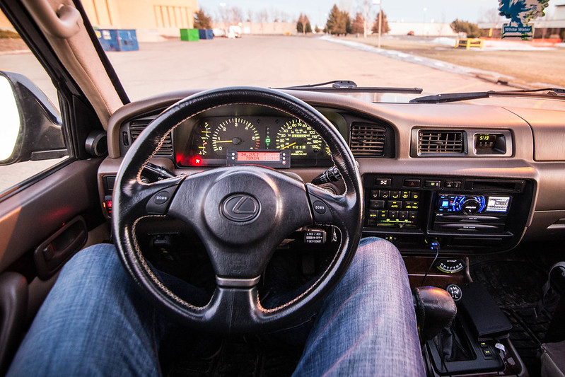

IS300 Steering Wheel Installed:
20130116-IMG_2133.jpg by RickaShay24, on Flickr
Spline count is the same and the wheel is currently installed. Still need to figure out the wiring for the cruise control module and also get the airbag working. I found an OEM Toyota airbag adaptor that I ordered so, fingers crossed, that will make the bag work. Cruiser control shouldn't be too bad as the connector on the IS300 wheel and the body-side of the steering wheel harness on the LX, are identical. They are however pinned in a different order but once I get some time I think the wheel will be 100% functional!

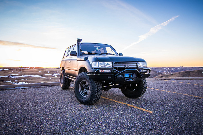

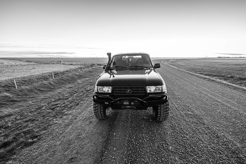

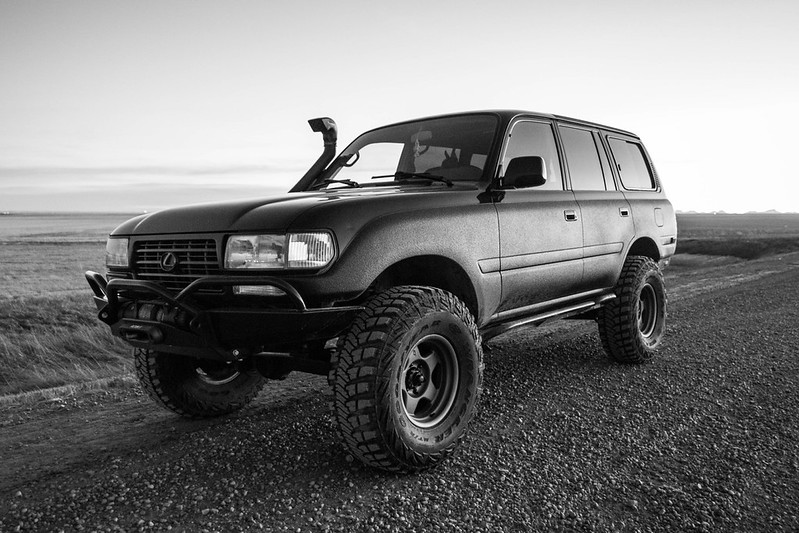

- And took some poser shots with my new lens....
20130116-IMG_2136.jpg by RickaShay24, on Flickr
20130116-IMG_2142.jpg by RickaShay24, on Flickr
20130116-IMG_2123.jpg by RickaShay24, on Flickr

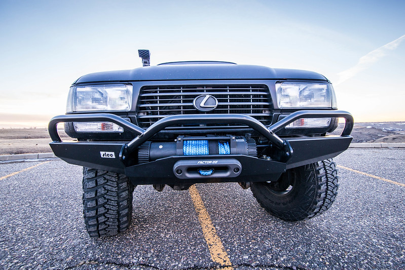

Factor 55 lookin' purdy:
20130116-IMG_2130.jpg by RickaShay24, on Flickr
Dead Sexy, that's a nice looking fairlead, Ill have to check those out. Will you be going to a larger F55 or what? I am about to sell mine as well, it just seems to be more of a hassle when i need to use it than i ever thought it would be. Soooo, did you ever sell your TJM hook?
The larger ProLink XXL is an option and will fit my line but it's 5" in length and combined with my 1.5" fairlead, that means my thimble would stick out 6.5" inches from the front of the bumper. I honestly think it would negatively affect my approach angle. At this point I'll probably order one for the amsteel Blue hooks to match the line I got. The Amsteel hook is rated for 25,000lbs and I'm actually not sure of the rating on my TJM hook. My TJM hook is in fact sold anyways.... lol

I love the steering wheel swap, that one will totally be worth the time it takes to make it fully functional.

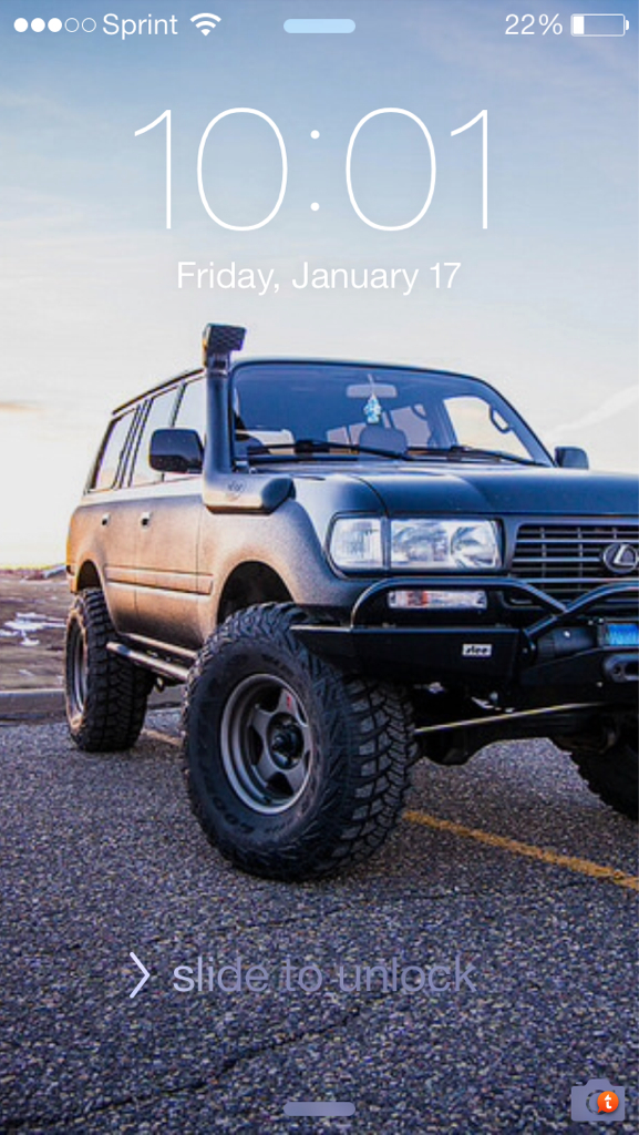

Haha Tom Cruiser is honored to hold your spot on the wallpaper. Thanks and the steering wheel swap WILL be 100% functional!

Is300!
Ah man that IS300 steering wheel is sick! Makes me miss my IS300 all over again. :)
