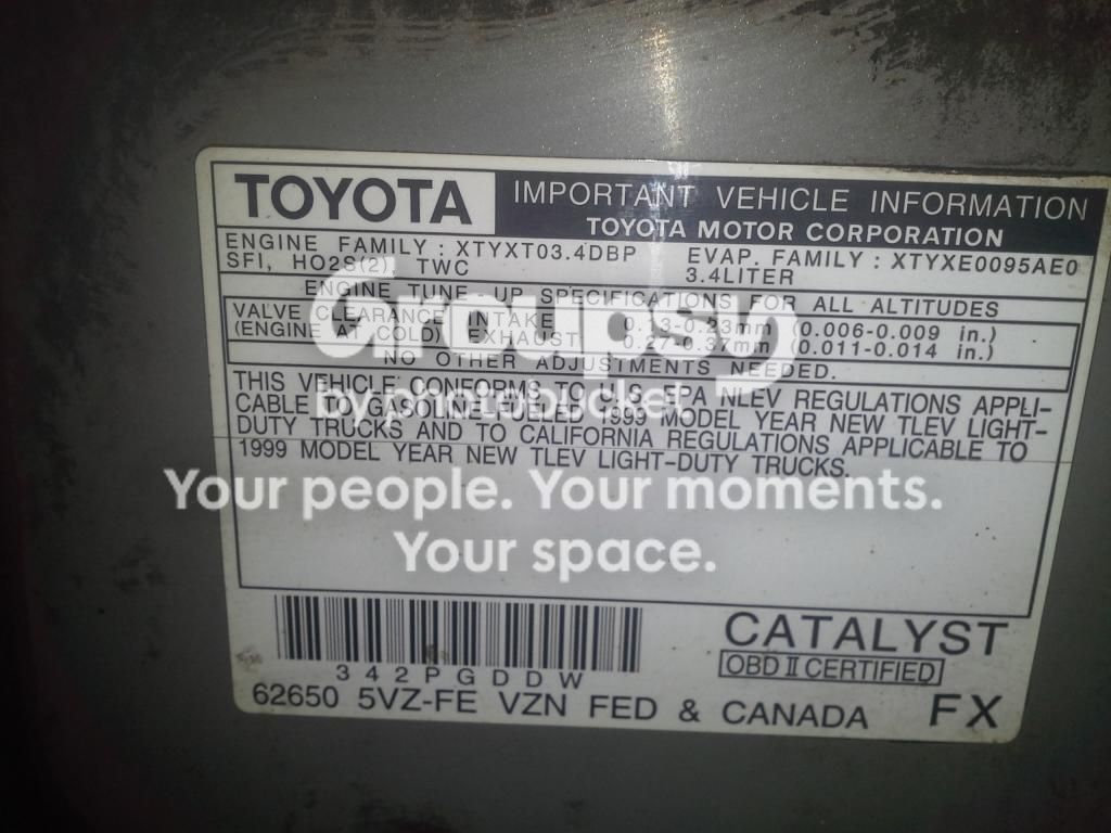

Hi,
Could use a little help clearing up some confusion. I've searched the site for an answer but I'm stumped.
I have a 99 4runner V6 Auto 4wd that threw out 3 codes:
  • P0125
  • P0130
  • P0133
Based on what I've read, I'm planning to replace both the Upstream and Downstream sensors just to be safe.
The 4runner was originally purchased in Pennsylvania, but the VECI label states that it meets California emission standards. So I'm not sure whether I need to get an Air/Fuel Ratio Sensor and an O2 sensor, or just get 2 O2 sensors.
20140805_093443.jpg~original
Any help is much appreciated..
If you have 2 Cats, You'll need an AFR for the front, O2 for the rear. These are the part numbers.
If I were you, I'd only use Denso products. Here are the part numbers.
If it's an automatic 4WD with V6:
Front: 234-9002
Rear: 234-4153
If it's a manual 4WD with V6:
Front: 234-9003
Rear: 234-4153
If it's an automatic 2WD with V6:
Front: 234-9002
Rear: 234-4155
If it's a manual 2WD with V6:
Front: 234-9003
Rear: 234-4155
If you have 1 Cat, you'll need just 2 O2 Sensors.
Front: 234-4162
Rear: 234-4162
Front: 234-4161
Rear: : 234-4154
I don't have links for the 2WD parts, but I am sure you can find them. Those amazon links may not be the cheapest, they were just the easiest to find, and I love Prime shipping...
Front: 234-9002
Rear: 234-4153
Front: 234-9003
Rear: 234-4153
Front: 234-9002
Rear: 234-4155
Front: 234-9003
Rear: 234-4155
Awesome...thank you very much for the info and links!
