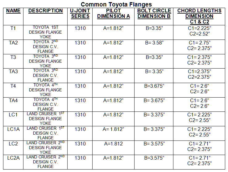

Mine's a 99 4x4 ltd, anyone know the flange bolt spacing for the front and rear and the length?

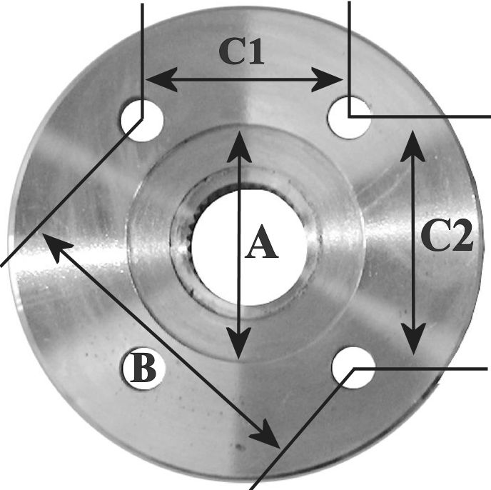

I measured 45 1/2" shaft, Round flange (4") and i believe it's a (2.5") spacing from bolt to bolt, but Tom said he think it's (2 3/8"). Can anyone confirm if it's 2.5" or 2 3/8" for the bolt pattern? thnx
Which end are you talking about? My dims were different between the T/C side & the rear diff side. I had 2.375" on one side & 2.6" on the other. Measure them again so you get the correct DS delivered. 5 speeds & 3rz's can be different. My DS is 48.625". That's why he doesn't save sizes.

Thanks, i got my measurement and it's on order with Tom, be here by friday.
My front is 2 5/8" , rear is 2 3/8" and 45.5" length.
