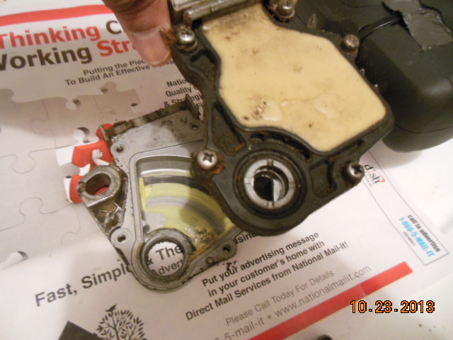

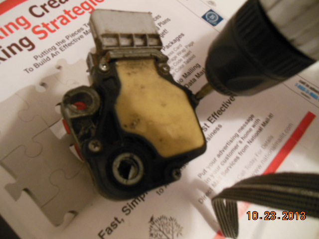

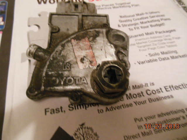

I have played with this switch several times.
Not that bad to remove. It is on the passenger side (US 4runners) If you turn the wheel all the way to left, and look at the transmission from behind the front right tire, you can see it mounted on the transmission.
To remove it from the truck, first remove the wire plug on the top by pressing the tab on the plug. Then there is a 10 or 12 mm bolt that mounts the unit to the transmission body.

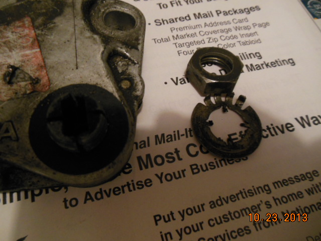

There is a 17 mm nut in the middle. after removing this nut, you can see 4 metal tab holding the shaft that comes out from the transmission. Slowly pull the unit from the transmission. Do not try to pry those small metal tabs, as they tends to break easily.

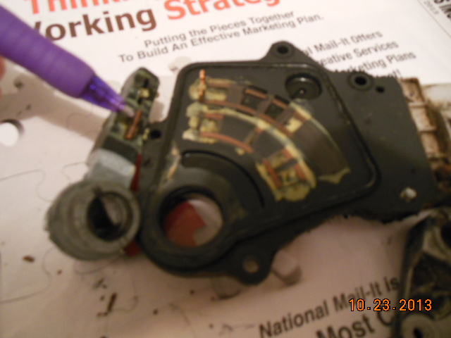

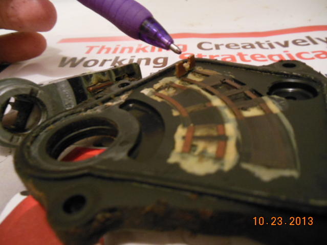

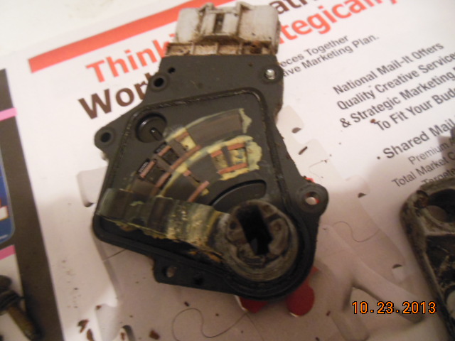

You in fact can remove the Neutral safety switch and clean the inside points. There will be 2 or 3 copper metal plates touching some pins. I opened mine and cleaned those.

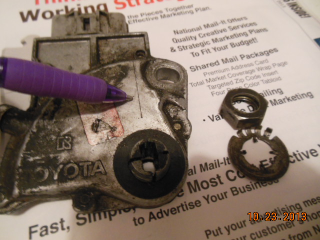

When you are ready to mount the unit back on the transmission, get the shift leaver to Neutral position (this bring the shaft coming out from the transmission at the neutral safety switch to line up in 6-12 O clock). Now insert the switch and you can see a straight line embossed on the switch. Keep this line also on 6-12 O clock.
Now get the 10 or 12 mm bolt and tight it. then use the 17 mm bolt and tight that too. Put the wire plug back.
This is all I did.
3rd picture shows the line that should be in 6-12 O clock. Also notice the two copper contacts at 7th and 8th picture. The spring inside the arm can be slightly extended. Also clean the copper plates in the main base.
Let me know if you need more help.

This thread has been a great help. My '98 4runner was having problems starting and would sometimes kick in when I giggled the shift lever and/or put it in neutral. It was getting more and more difficult to start and a friend suggested I look into the neutral safety switch, which is when I found this thread. The directions nissanh gave was great. However on my '98, the center nut was larger than 17mm. I didn't have a bigger wrench and had to use an adjustable one. I also had to use a flathead to slowly pry the part from the shaft. I replaced it with an after market part I bought for $159. When tightening the center nut, the shift lever (which was in neutral) would move, so my friend had to hold the lever while I tightened the nut. Since the part was new, I had to bend the prongs toward the nut to help keep it from loosening while shifting. The car seems to be starting fine.

For two weeks my '97 4Runner was randomly not cranking or clicking or anything when I turned the key. The remedy was to manually connect the starter relay and she would crank right up. This indicated that the starting sequence from there down was fully operational, and shifted the focus to the components between the ignition and the starter relay. The Neutral Safety Switch never came to mind and mental preparations were under way to tear into the ignition when procrastination brought us to this thread. The post by nissanh with detailed photos inspired a change in course which led directly to the problem. Our Neutral Safety Switch was discovered hanging on loose bolts and its wire harness packed with grease. Thanks to the clear instructions from nissanh, the unit was removed, cleaned and reinstalled in less than an hour. Turn key, crank, start, No Problem.

cleaning
I appreciate the neutral switch post.I am going to follow your directions..i would prefer to keep my original component...its probably good, just grime hopefully and minor adjustment...what did you use to clean both the guts and the copper..thanks
I just clean the contact points with a sand paper (1000 grit should be good). Make sure to add some dielectric grease before you put the parts together.
