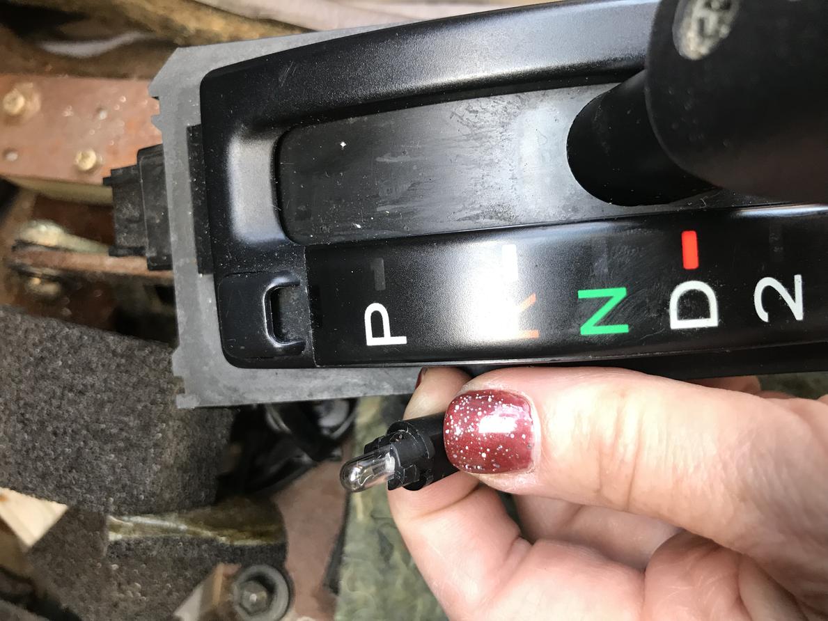

Don't understand why you have to remove the shifter knob. All the other things are good. When you pop up the shifter bezel just lift it up and out of the way. The boot will hold it out of the way. The most difficult part is getting the bulb socket twisted out and twisted back in as it goes in the bottom and there's not a lot of room between the socket and the body "hump". Also, I believe the side panel on the center console adds to the obstruction but I think you can get to it without removing it. May need a pair of long needle nose.
See here

It's a bit of a pain.
Do you happen to have some non-slip fabric (like Jar-Gripper)? That's what I used.
Just work at it, side to side, and it will eventually come out.
Ok and it just pulls out . Got it.

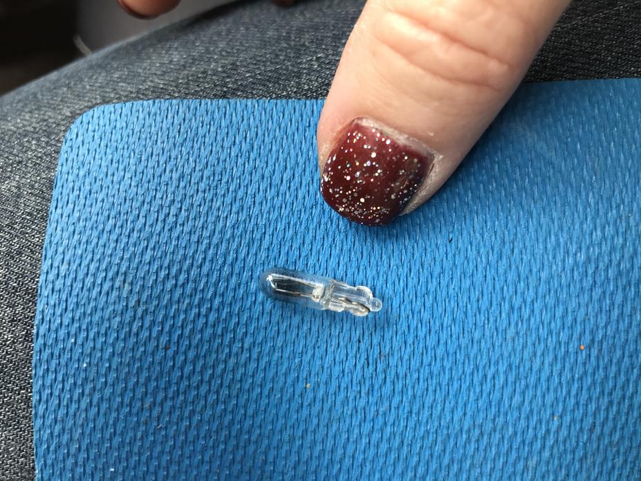

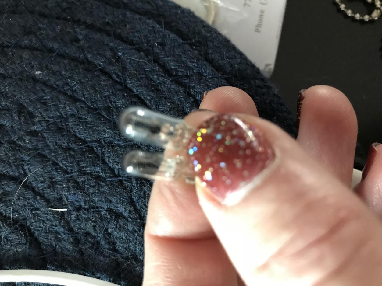

I got the 74 but it’s too big.
On left is what I pulled out. Right is the 74.
Is left an led? Now what?

That's not a #74. Looks like a #24. I got mine at first from Advance AP. Just go back and get the next size smaller wedge style bulb. And that other is not an LED. LEDs have at least a resistor and sometimes a zener diode visible in this wedge style bulb. I got these from superbrightleds.com and they actually were somewhat loose in the socket. Put a small dab of epoxy on it. You'll have the same bulb in the key ring and the glovebox.

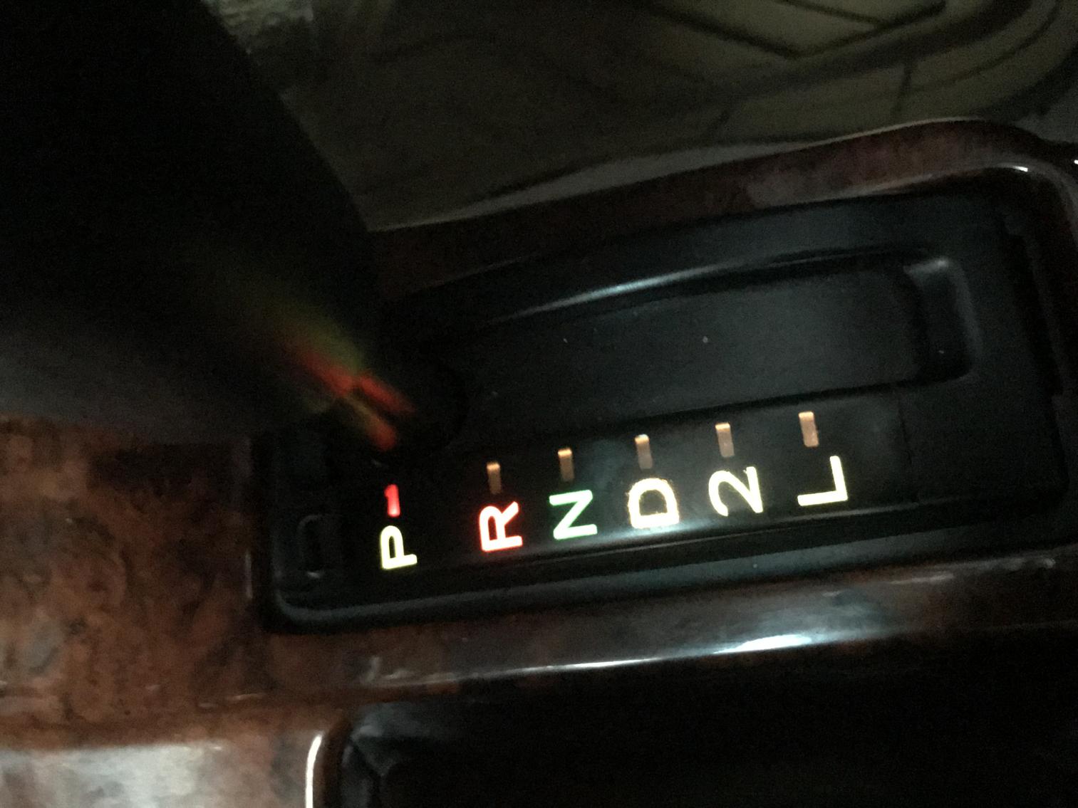

Got the little bulb at dealer for $3 and got it done.
Yay for small successes.
