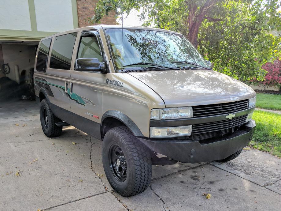

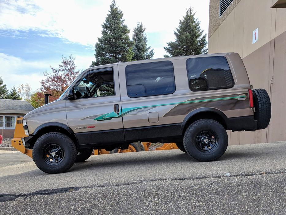

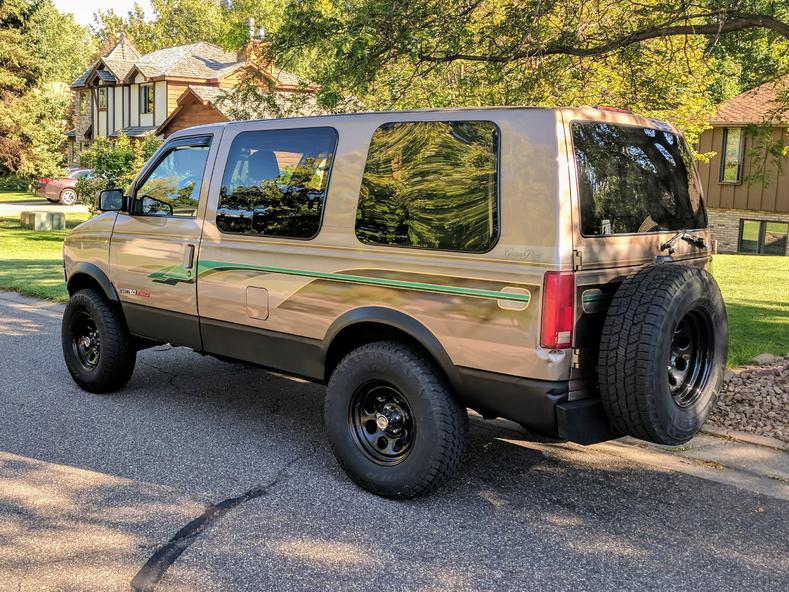

Came across your build thread and have been reading it with my wife for the past hour. Your story is a great one, and it's awesome seeing a young guy grow into a man with his T4R. My mom bought a new 2002 T4R when I was 16, and 16 years later it is mine. Last summer my son and I built up an Chevy Astro into a family adventure vehicle, and after that sells we will be building up our T4R for a much more capable off road vehicle.
Before reading your build I had come to the conclusion it would be best to go ahead and spend the money to get a Sonoran 1.2 lift instead of piecing together parts. SS1.2 seems to have a great ride both on and off road, and also comes with the various other parts to complete the install. Then I see your early adventures and it seems like SS1.2 might be an unnecessary expense. What are your thoughts on this?
Here is the Astro we built last summer..

Thanks! Thats really cool! That Astro looks like a great camping rig.
