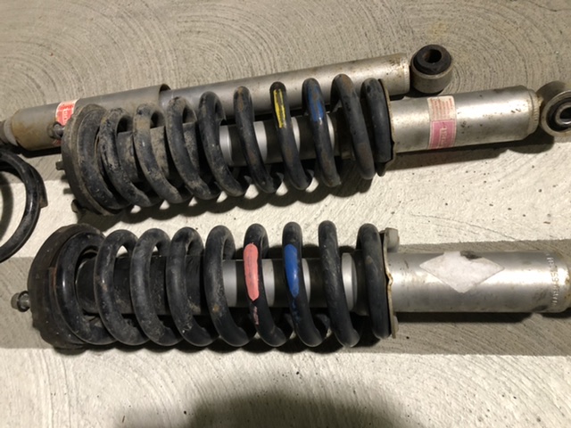

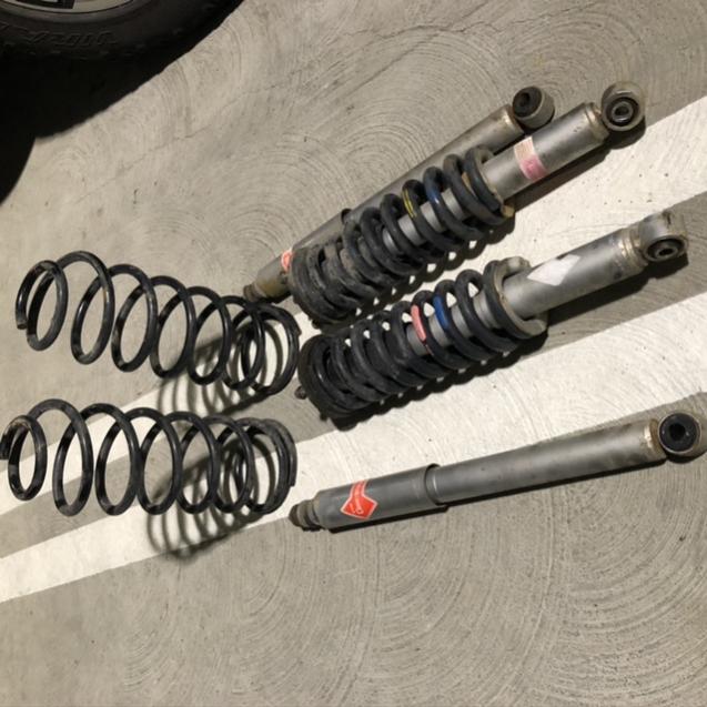

I just removed front and rear shocks/springs from my 99 4Runner. Bought this a year ago and the previous owner said the suspension was fairly new.
I see the front coils have pink/blue and yellow/blue markings. For the rear coils, I can’t find any markings.
Does that mean my rear coils aren’t the 99 tall coils?

If there is no paint splootch on the rears it is likely they are moog replacement or some other aftermarket spring. The 99 tall rears sag out and may have been replaced. The fronts don't seem to degrade.

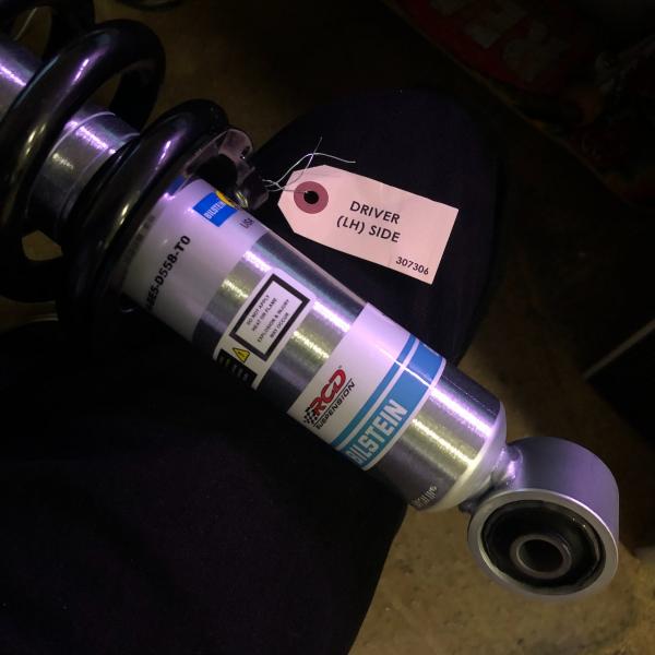

Went with the 3” Toytec Ultimate Lift Kit. The KYB shocks was good on-road. Only drove it for about 1k miles before I swapped them out, but overall they weren’t bad. The ride was a little on the stiffer side but not much.
