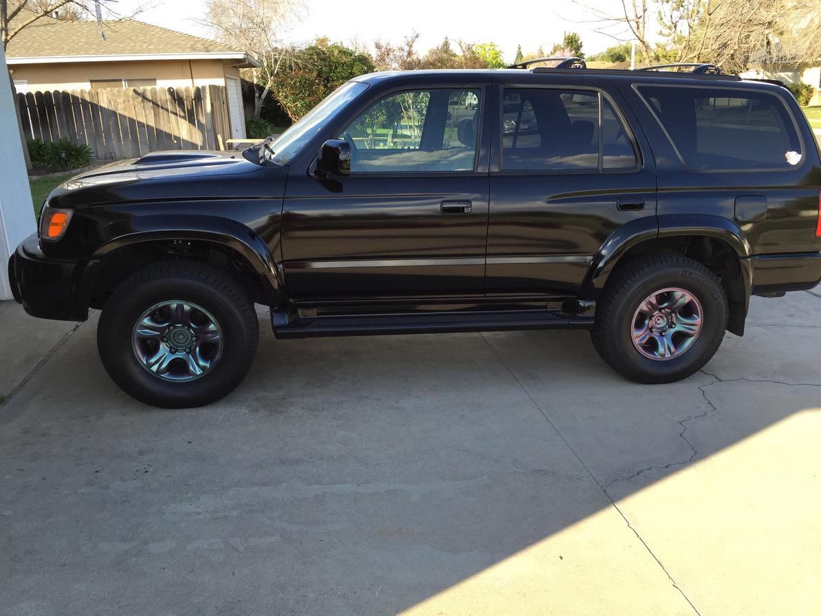

Ok so i have a bone stock suspension 2001 4x4 limited. It just got new stock shocks when I bought it in may and new tires in October so I can't justify buying a whole lift right now but I wanna give it a little better stance, so can yall post some pics of 4runners with 99 talls on it? and does anyone know the exact part numbers they used for the coils?
Don't have a pic right now, but I replaced my rear coils with talls to combat the sag and I like it. I have a 2001 too. Since i didn't replace the fonts I'm getting a touch of rake, which I like.
If you are not looking to wheel, dont want much of a lift or are living with stock sagging rear spring (as we all seem to at one point) and just want to fix that then 99 tall spring are a great way to go and will give .5 to 1 inch of lift depending on year and spring wear. If you are planning to wheel or want to do a lift then save up and just do a good lift kit. My stock sagging springs with new kyb shocks do just fine off road for now as i save up for my lift.:popcorn:

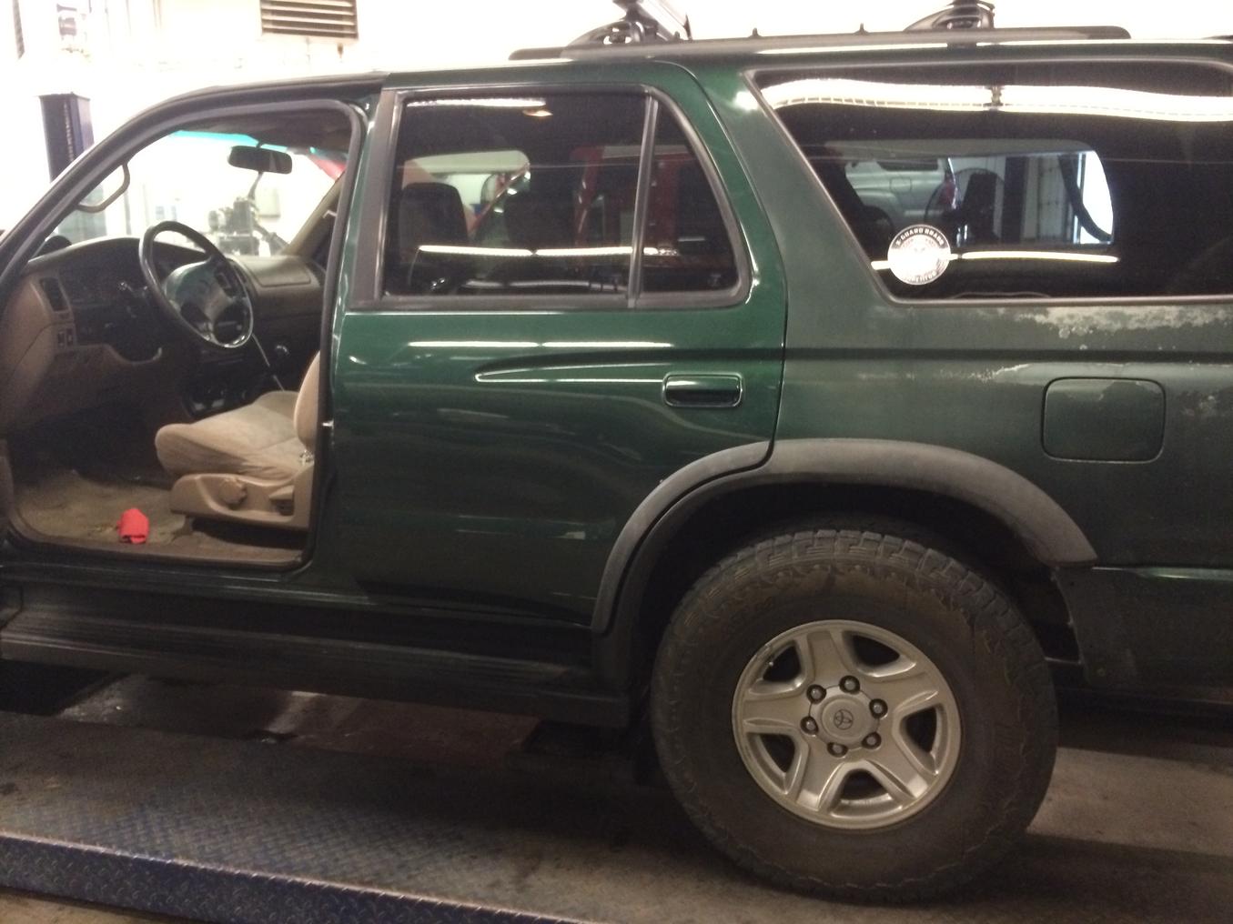

This was how it sat before I swapped out my 99 tall with Superflexes. About 20" fender to hub (rear). In case anyone is interested, they are just rolling around in the back of my car, waiting for a new home.
What was your reason for the swap?
I just replaced front 01 stock coils, for the 99 talls along with some 4600 blistens ubj and a right cv axle. I got about 1.25" lift in front from ground I was 34.5" now sitting at 36.75".
Well I swapped because I wanted something other than OEM lift and more clearance and more travel and better off-roading performance.
