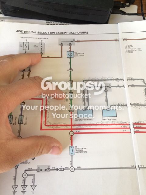

Yup, no computer on a J-shift set up. Maybe I'm reading this wiring diagram wrong then, or its for a different year. The way I'm reading it, it goes from ground to the 4wd selector switch, splits up to the Engine ECU and to the ADD indicator switch, then to the light bulb.

OOPS. I take it back. I looked at it too quickly and decided it showed what I THOUGHT was the case. My sincere apologies. 1999 is quite different though, but not in that respect. The "except Cali." leads me to believe that yours must be the 2000. 1999, even though Cali's existed, has no separate diagram.
Like you, I see no reason it has to be that way. How often will the TC not engage if the J-lever is in position for 4wd? More to the point, how often will the ADD engage if the TC has not? Wouldn't you prefer to know that it has, when you were not expecting it to? As in, if you have a VSV fail and vacuum stays on in 4wd while the J-lever and TC are in 2wd, the light will go out because the TC goes out, while your front diff stays locked and you won't know until you do a turn on a hard surface. Hummmph. They really should have done it my way! :)
