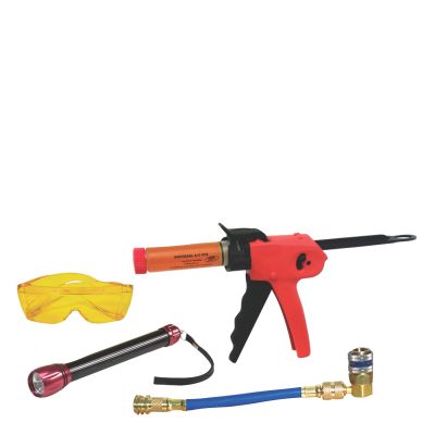

OK, so my friend and I recharged the system and it popped right on, nice cold A/C as you'd expect. That was a few weeks ago. Today it warmed up and I turned it on and once again got hot air. Clearly there's a leak somewhere...any input on how to troubleshoot this? I read that there are dyes you can put into the system to find the leak...do they work? Or should I just take it to a shop? Thanks in advance.
leak detection kit. Comes with dye, light, and glasses.
Maybe easier for you to take it to a shop!
Yeah I'm thinking a shop might be the way to go. How often will I need an A/C leak detection kit, you know? Should just save the money and put it toward the repair.
Do leaks tend to be expensive repairs? I'm guessing it depends where the leak is...
Figured I'd first try the Toyota dealership I bought it from. No warranty but it's worth a shot to see if they'll check it out for me.
Just depends where it is in the system..
Sometimes it's just an Oring which is a cheap fix.
Other times it could be a hose, condensor, evaporator, etc which can get expensive.
Hopefully its just an oring or hose for ya. Could even possibly be a leaky valve core which is also a cheap fix.
You'll only need it once in this paticular case. But if you loose air agian in the future on this car or another its always handy to have with you. I have a shitload of a/c tools I've barely used but in the end it pays for itself.

Guys what is the eye in the evaporator supposed to look like when the system is charged? We added another can and I put some dye in there to find the leak. It's still blowing cold after a couple of days, and I can't see any leak yet under a blacklight. The eye in the evaporator looks as if there is milky white liquid passing through it quickly...is that what it's supposed to look like when charged?
